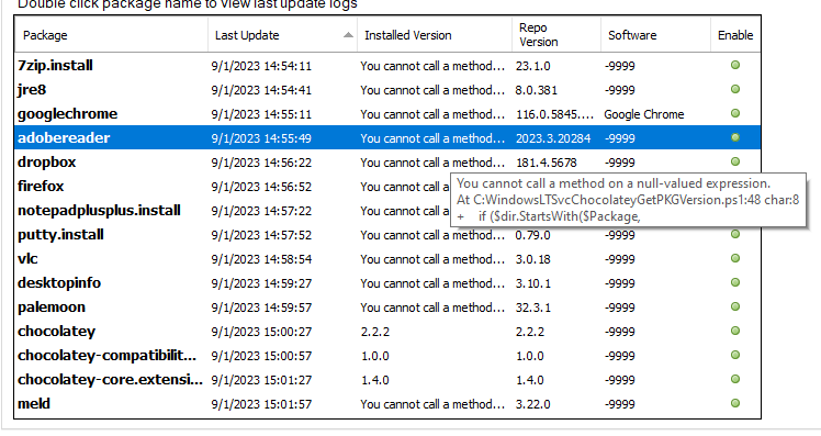

I looked at LTErrors.txt and see this...
30.347 - 8/29/2023 4:06:20 PM - Error Deleting File: C:\Windows\LTSvc\Chocolatey\packages\dropbox.181.4.5678.nupkg, The process cannot access the file 'C:\Windows\LTSvc\Chocolatey\packages\dropbox.181.4.5678.nupkg' because it is being used by another process.:::
This is error says that the file "dropbox.xxx.nuget" is still in use and can not be deleted. This could be a lot of things. It could be some file lock on this file from PC hosting files or another agent currently using file to install package. Any reason that this file would be "open" when agent tries to delete. In this case its a local file (C:\Windows\LTSvc\Chocolatey\packages\dropbox.181.4.5678.nupkg) so this error would be the local agent still has file open and the script tries to delete. So question would be , why did agent return from install or update command and then after that tried to delete file but yet it is still in use? From scripts perspective it should be dormant as script is no longer executing a install or upgrade command.
Maybe that file is stuck from a previous botched install and is being held open by OS? I would not know from logs.

I just don't know which script logs you want me to check, as there seem to be in excess of 200 per day - per machine...?

I tried on 1 machine to install 7zip from repo cache... it did not get installed... this is in the command logs:
Parameters:
cmd.exe!!! /c "C:\ProgramData\chocolatey\choco.exe 7zip.install --source %ltsvcdir%\Chocolatey\packages\ --version 23.1.0 -fy"
Output:
Chocolatey v1.1.0
Could not find a command registered that meets '7zip.install'.
Try choco -? for command reference/help.
Not sure if this is an issue, but the double-quotes are not closed after choco.exe
Also... the path is set to c\programdata\chocolatey\bin - I have read in some places, that it should not have the \bin... furthermore, wondering why choco is not updating from 1.1.0 to 2.2.2.
The script failed:
The Script(6200) failed in the Else section at step 121. The reason: Either `@LOOPCOUNT@` or `1` is not numeric

  • Hopefully the correct command will fix some of the issues in my second previous post as well - like the chocolatey update?
  • Specifically, it looks like (on my own machine) 7zip had a dependency for visual studio libraries - are dependency updates not considered and applied as needed?
Choco did update on my test machine after applying the new version... but take a look at the log... it looks like it may not have found the package on the caching agent and may have downloaded it from the choco online/community repo???
If that is what's happening and it isn't using the caching agent, that may be why most apps are not getting updated/installed b/c they are getting blocked.

Also, in an attempt to update from repo cache... here is the jre8 attempt, but each app gets this:
Install of jre8 returned -> [Chocolatey v2.2.2
Could not find a command registered that meets 'UPDATE'.
Try choco -? for command reference/help.]
Most are now installing on this test machine at least... What does the error in 'installed version' mean?

Well... I retract the statement above... even though the apps show in 'Managed Applications', the ones that have that error under 'Installed Version' do not appear to be installed at all.
The command is invalid, That was a typo on my part. It should be upgrade not update. I've fixed that in 3.5.0.15.
Lets see if this corrects your issues. I reviewed the script and if packages are available it should install them.

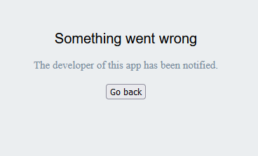

The link for 3.5.0.15 is not working
Screenshot 2023-09-06 090225.png (43.93 KiB) Viewed 223847 times

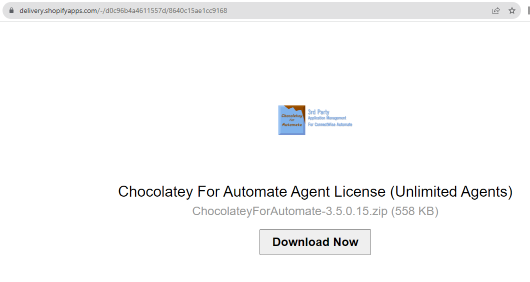

This is what I get when I click link... Maybe copy and paste link, I reposted link again below
https://delivery.shopifyapps.com/-/d0c96b4a4611557d/8640c15ae1cc9168
