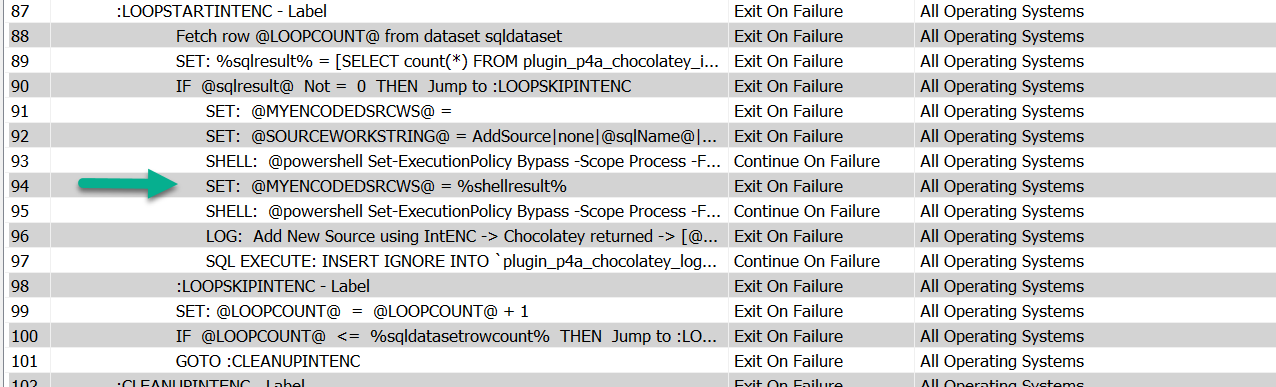

I hope you see my post before ? Do you have the same strange effect on the vars in the script ?
I see no reason, why the %shellresult% is not put into the @myencodedsourceworkstring@
in debug, after execute og line 93 the var @MYENCODEDSRCWS@ is empty
Then i added line 94 and set @MYENCODEDSRCWS@ explictly to %shellresult%
After this change my source is added to the list. But is it correct, that theres is no default source with priority 0

That is strange, and yes, I see odd things with CW all the time—things that should work but don’t. A partial reason for this isssue is that there are areas where we call script execute on a PowerShell process, and other areas where we write out the PowerShell script to a file and then execute the file as a shell execute command. Both do the same thing, but we’ve found that if we have to write variables out to a script, sometimes it works and sometimes it fails. Also, Execute script runs a different PowerShell instance, so importing modules and installing modules can be a real pain.
Your fix is valid, and I will add this to our scope.

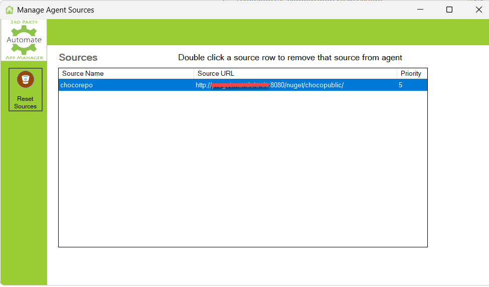

-> sorry, but it does not work. i have agents where choco sources shows the correct 2 repos and
manage agent sources shows only one.

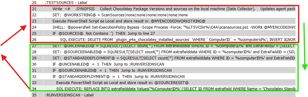

After a review of the script, you are correct. The source scan was in the wrong position in the script. We have several tests we perform to see if we need to perform a default source reset before moving on to package versioning functions. The source scan processes need to be performed before these tests, as the tests will send the thread to the version scans function after tests causing source scan to be skipped.
I have corrected this action in build 3.7.0.15.
Here is what that correction looks like, Moved lines in red above lines in green.

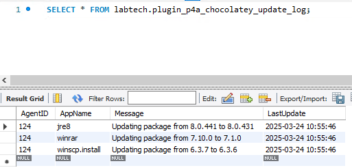

3.7.0.15 is shaping up to be a nice release when it gets pushed.
Fixed several things, updated a few things and am now using the new update logs table in mySQL. This is the first step in getting valuable reports in Chocolatey for Automate. Individual package update versions by date updated.
Screenshot 2025-03-25 131921.png (17.69 KiB) Viewed 19707 times
As you can see we have a typo in our logs, correcting that. (This is why we test and test again...)
