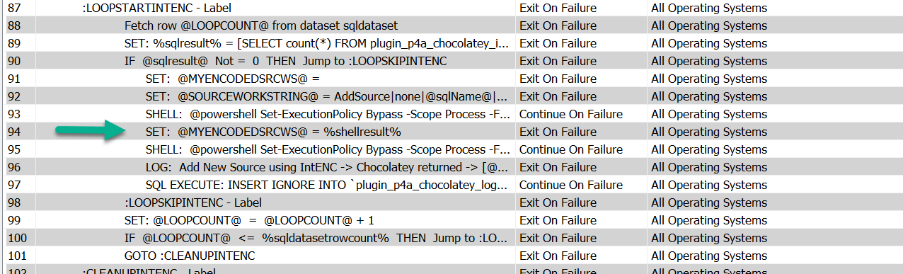

after a litte testing:
if i use a fresh uninitialized variable which is not set in line 91
(eg @MYENCODEDSRCWS@ ) then it is filled corretly in line 93 und if i use it in line 94
the command works
maybe a bug in connectwise ? Variable set as contant maybe a string var which is not long enough to take the uuencoded string ?
i also tried to copy shell result of command line 93 manually in debug to the var @MYENCODEDSOURCEWORKSTING@ and this works, too.

I hope you see my post before ? Do you have the same strange effect on the vars in the script ?
I see no reason, why the %shellresult% is not put into the @myencodedsourceworkstring@
in debug, after execute og line 93 the var @MYENCODEDSRCWS@ is empty
Then i added line 94 and set @MYENCODEDSRCWS@ explictly to %shellresult%
After this change my source is added to the list. But is it correct, that theres is no default source with priority 0

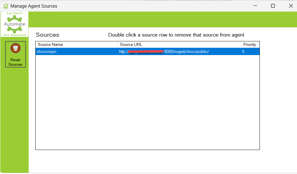

sorry, but there is another problem.
It seems, that setting sources seems to work with my little change.
But if i in a client-> Computer right click -> Manage Agent Sources, it shows not the same as if i use
choco sources directly on the agent.
Which script is setting the database entries for the sources ?

-> sorry, but it does not work. i have agents where choco sources shows the correct 2 repos and
manage agent sources shows only one.

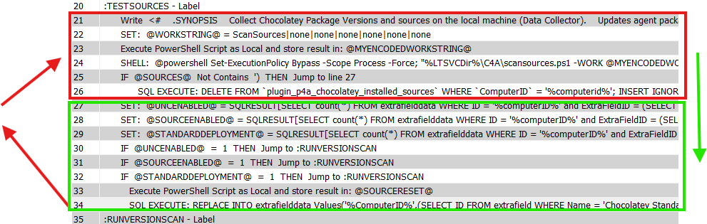

Re: scansources.ps1 error
After a review of the script, you are correct. The source scan was in the wrong position in the script. We have several tests we perform to see if we need to perform a default source reset before moving on to package versioning functions. The source scan processes need to be performed before these tests, as the tests will send the thread to the version scans function after tests causing source scan to be skipped.
I have corrected this action in build 3.7.0.15.
Here is what that correction looks like, Moved lines in red above lines in green.

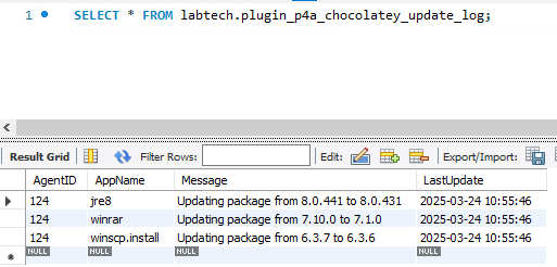

Fixed several things, updated a few things and am now using the new update logs table in mySQL. This is the first step in getting valuable reports in Chocolatey for Automate. Individual package update versions by date updated.
Screenshot 2025-03-25 131921.png (17.69 KiB) Viewed 19690 times
As you can see we have a typo in our logs, correcting that. (This is why we test and test again...)
