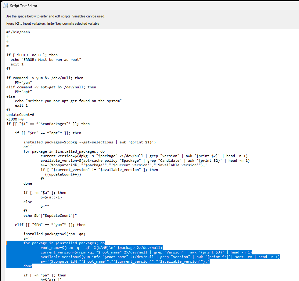

From what I can decern,
There are maybe 2 packages that are in the package list that are failing to "get more info" when we loop through each of the available packages.
Since I do not have an Oracle box, can I have you try a few things to see if we can resolve the issues?
#1 Modify Scanner script (APM Agent Scanner)
Open line #28 (Should hold a bash script like below)
Find the highlighted code block as seen in image below.
Screenshot 2024-02-27 111030.png (55.61 KiB) Viewed 8973 times
Replace the loop (6 lines of code) with the following updated code loop.
        for package in $installed_packages; do
                root_name=$(rpm -q --qf '%{NAME}\n' $package 2>/dev/null)
                current_version=$(rpm -qi "$root_name" 2>/dev/null | grep "Version" | awk '{print $3}' | head -n 1)
                available_version=$(yum info "$root_name" 2>/dev/null | grep "Version" | awk '{print $3}'| sort -rV | head -n 1)
                a+='(%computerid%,"'$root_name'","'$current_version'","'$available_version'"),'
        done
The difference is I am now piping STDERR to null instead to terminal by adding " 2>/dev/null" to each command line we execute.

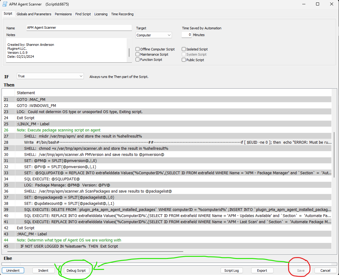

Make this change in bash script, save the LT script and then using the debug feature at the bottom of LT script, run script against the Oracle agent. It should execute script live for you to see what script is doing and what it is outputting when completed.

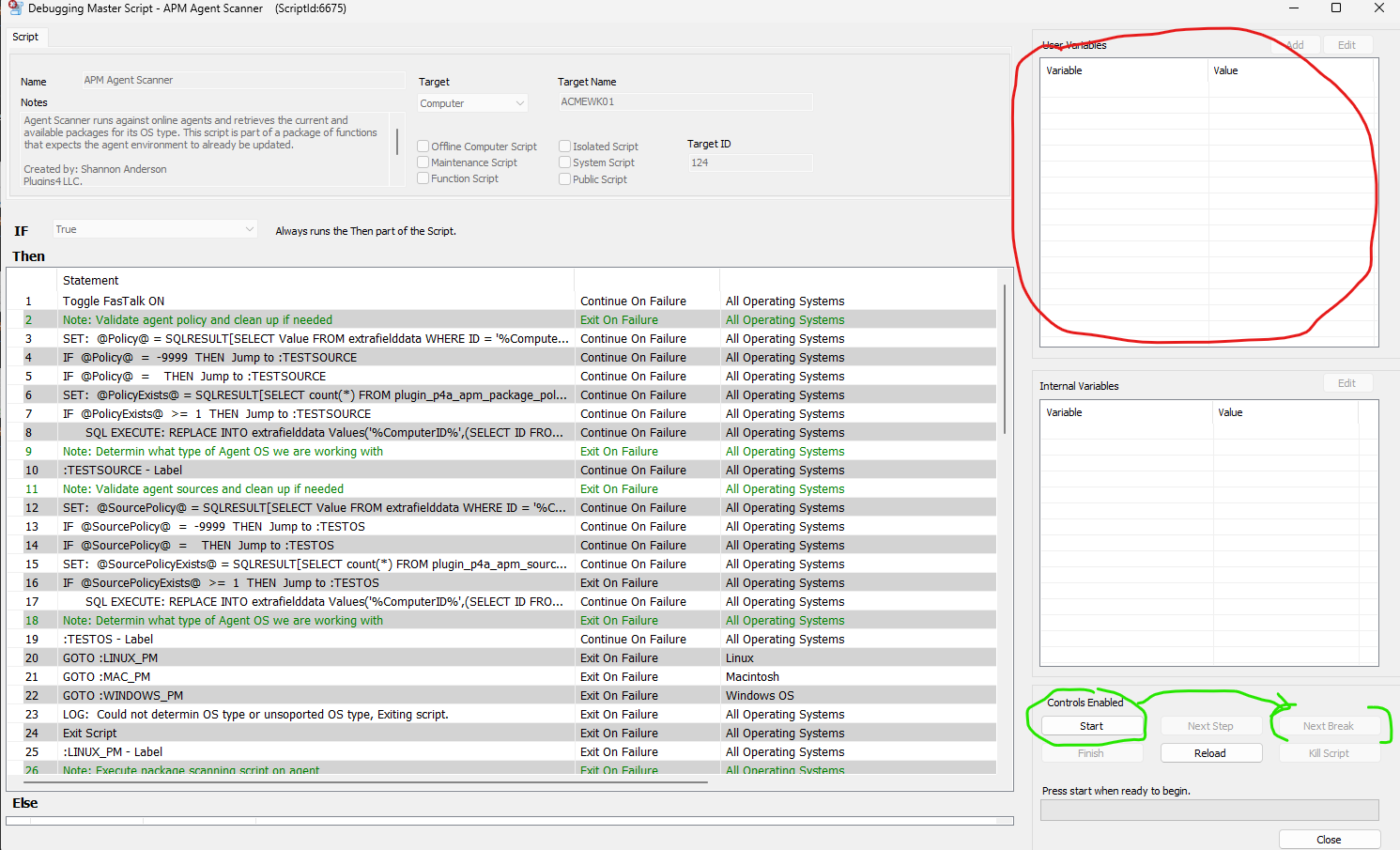

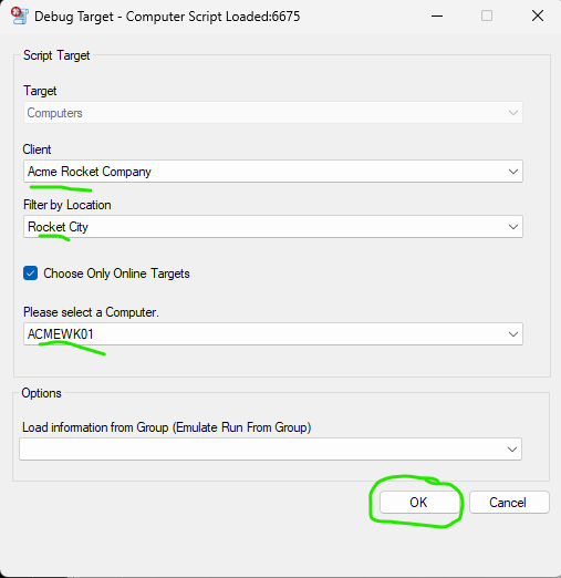

Running debug is pretty simple.
First select the agent you want to run script on.

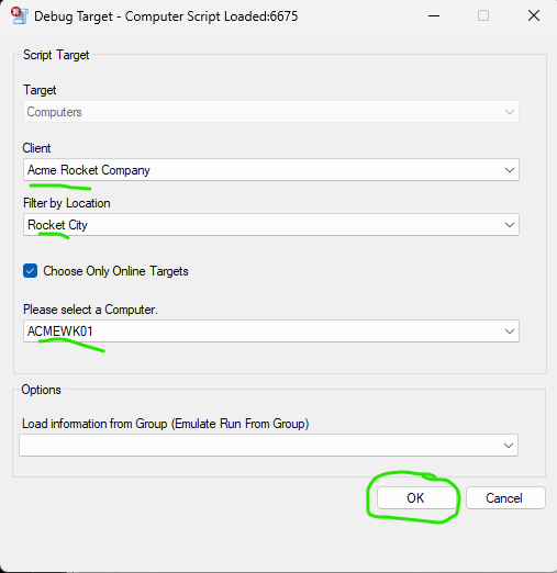

Screenshot 2024-02-27 112629.png (20.26 KiB) Viewed 8973 times
Then select start, wait for it to initialize and then select next break. It will then start executing line by line the script. When completed it will leave a list of return variables in box. Well check the output to see if it still has errors..
