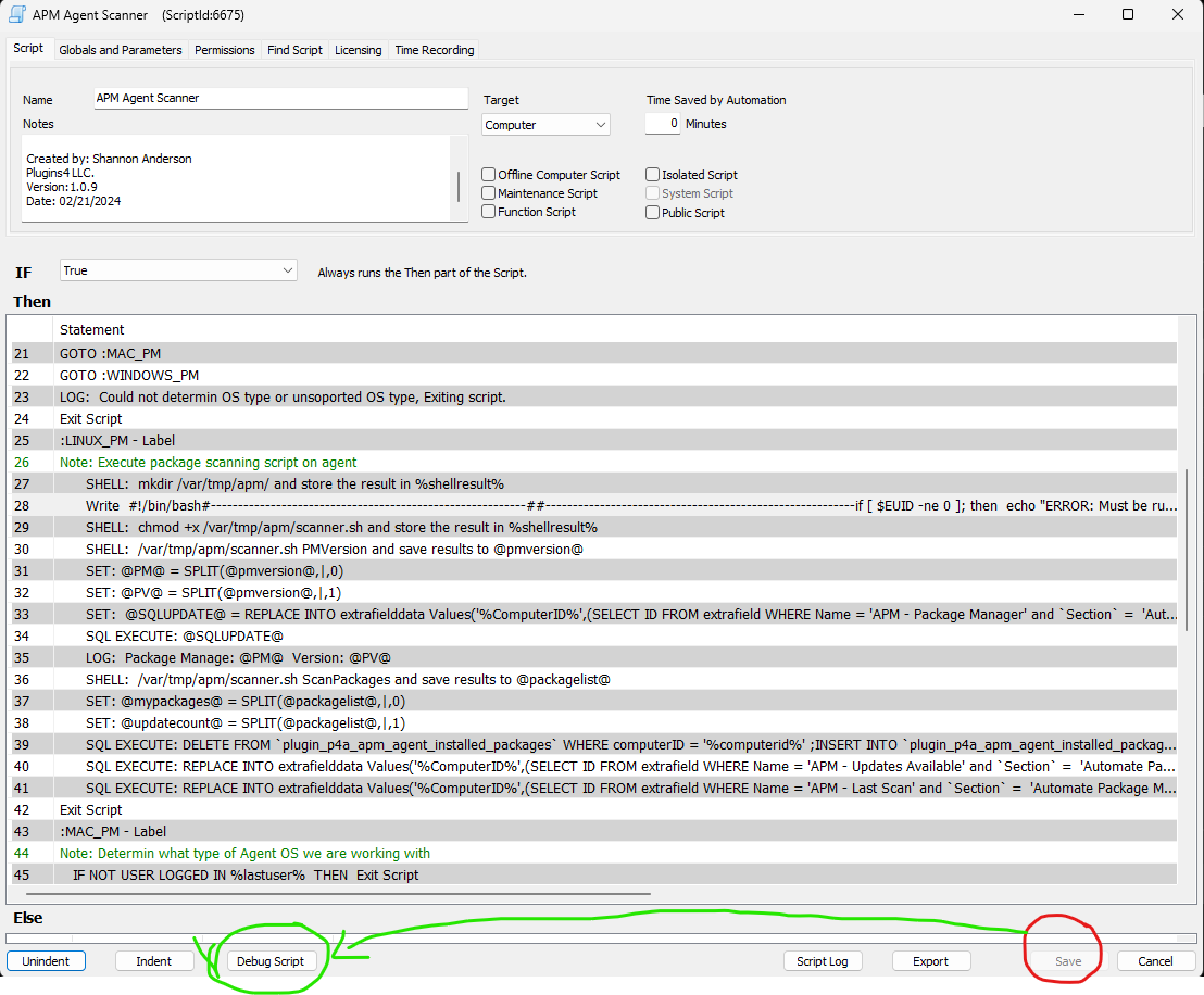

#1 Modify Scanner script (APM Agent Scanner)
Open line #28 (Should hold a bash script like below)
Find the highlighted code block as seen in image below.
Replace the loop (6 lines of code) with the following updated code loop.
The difference is I am now piping STDERR to null instead to terminal by adding " 2>/dev/null" to each command line we execute.
Make this change in bash script, save the LT script and then using the debug feature at the bottom of LT script, run script against the Oracle agent. It should execute script live for you to see what script is doing and what it is outputting when completed.

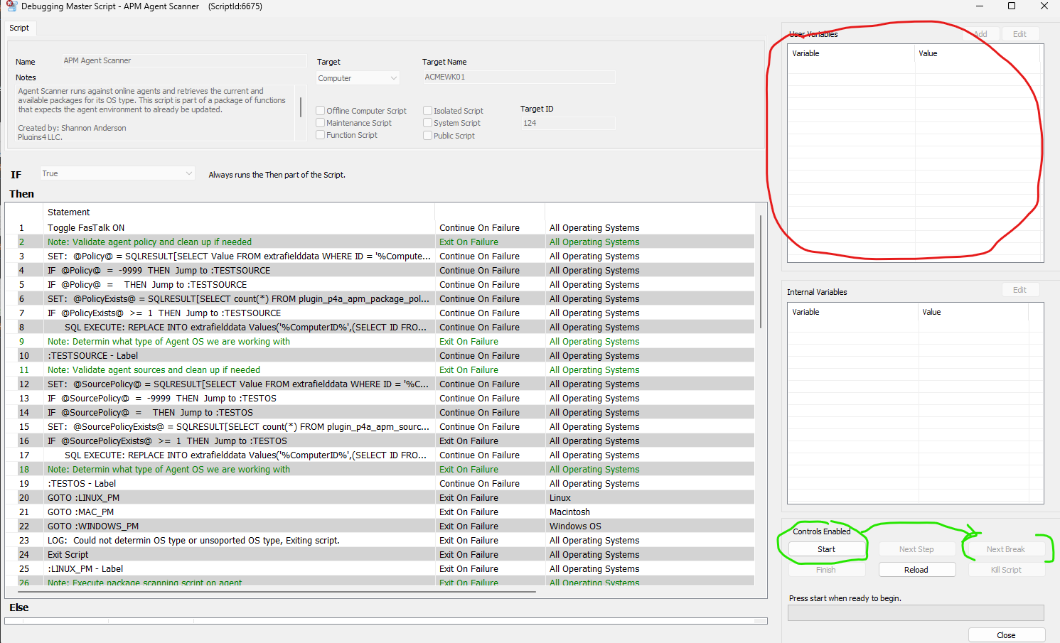

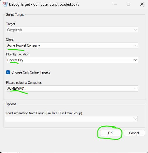

Running debug is pretty simple.
First select the agent you want to run script on.
Then select start, wait for it to initialize and then select next break. It will then start executing line by line the script. When completed it will leave a list of return variables in box. Well check the output to see if it still has errors..

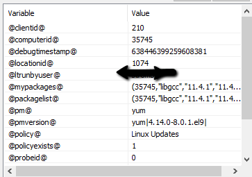

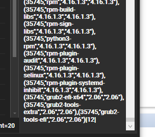

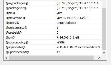

ran debug. attached images of results it did pass and I no longer see the errors

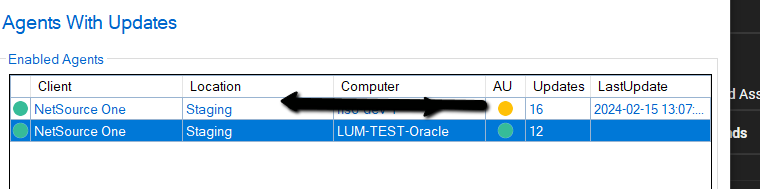

Re: Trying to patch a Oracle 9.3 (Linux) system it seems to find packages but they never seem to install
Good news it now appears to be registering correctly, as I see it listed in the agents with updates pane.
I manual told it to apply updates and it appears to be updating now, will let you know the result
- update4png.png (15.58 KiB) Viewed 8941 times
I do notice from the image above that this agent is not set to auto update.
So only manual updating will work until you adjust settings.
Remember, any agent set to auto update and does not have a policy set will test for updates daily.
