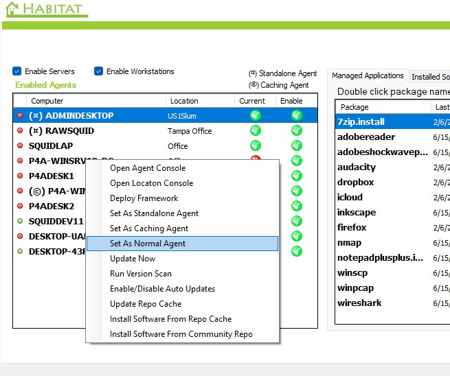

If you are on version 1.0.1.26 then you should have a "Set to Normal" menu item available to you on the agent menus. This will remove the caching agent duties from an agent. You can also select a different agent at same location and it will take over and auto remove the original agent from this duty.
So 2 ways to change or remove caching agent.

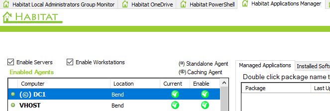

Thanks. We are still on version 24. I've enabled the servers and have made the server with the cache folder as the caching agent but the other is still showing as a caching agent even though they are on the same location?
As I don't think the non-domain WS is able to access it. I just ran the commands you provided and there wasn't a response. Tried to remotely access the shared folder through there but still failed.

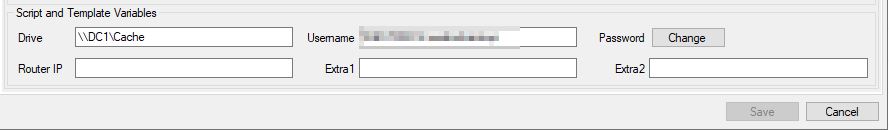

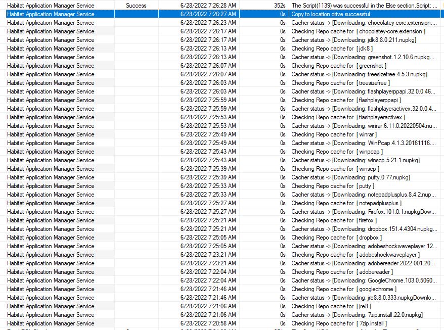

I just checked and even though script history for the Update Repo Cache shows as successful, I checked the cache folder I setup in the server and configured in Automate, and it still doesn't have any of the app packages. I don't think it is the permissions as I have confirmed that the account is correct as well as the share folder location.
Also, the previous caching agent still shows that it is so there are 2 caching agents now. For now, I've set it as a stand alone agent.

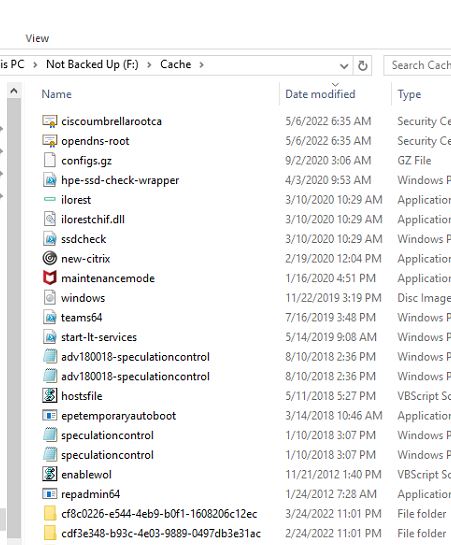

in the cache root should be a folder called habitat with a sub folder called packages
\\dc1\cache\habitat\packages\packagename.xyz
all packages should end up here as a result. The script should attempt to create this directory on cache so I wonder why it would not of failed out there first?
Folder does not exist?
as for changing agents, get updated to 1.0.1.26 and that feature will present itself in menu.
