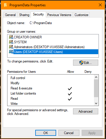

What is your security settings for the following set of directories?
Here is an example of mine, I have SYSTEM with full control which is what my Automate agent is running as. If you are using a different user to launch the Automate agent is that user have write permissions for the following directories?

My agent is running as System and my security permissions for folder C:\ProgramData match your settings.

Does it match at the Libs directory the same as it is here? Trying to understand why Chocolatey fails with permissions to execute from directory if SYSTEM has full control?
