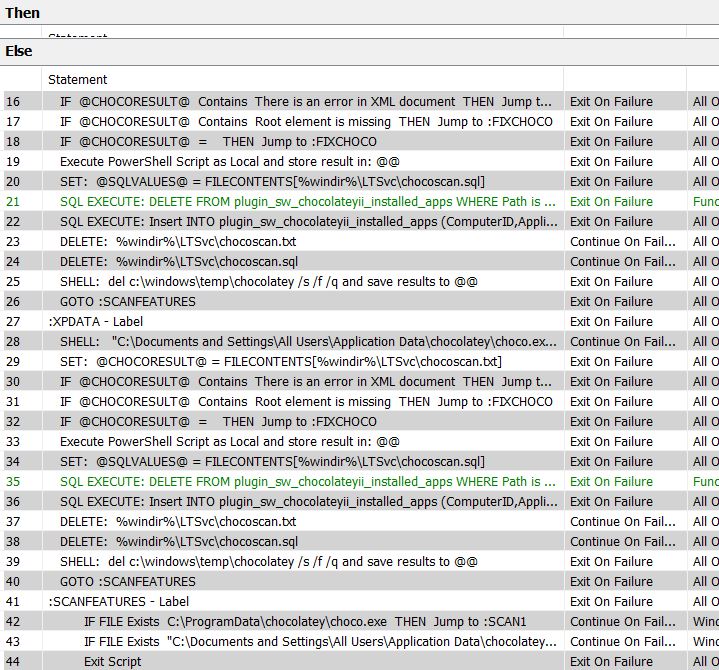

The following pic is the script of the ELSE section:
"This is try 1/3. Retrying after 300 milliseconds.
Error converted to warning:
Access to the path 'C:\Windows\TEMP\chocolatey' is denied.
This is try 2/3. Retrying after 400 milliseconds."
- Capture.JPG (165.72 KiB) Viewed 12561 times
Re: Auto-Install failing. "Access to the path 'C:\ProgramData\chocolatey\lib\"
Interesting inside your script line 25 should be set to "continue on failure" but is not. I have looked at ours and it is set as such.
Not sure why yours didn't?
If you make that change in script it should skip that issue on next runs.

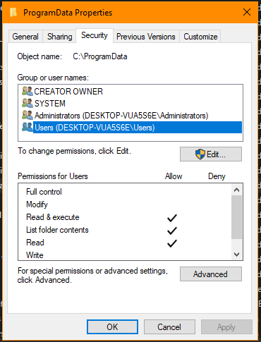

What is your security settings for the following set of directories?
Here is an example of mine, I have SYSTEM with full control which is what my Automate agent is running as. If you are using a different user to launch the Automate agent is that user have write permissions for the following directories?
My agent is running as System and my security permissions for folder C:\ProgramData match your settings.
Does it match at the Libs directory the same as it is here? Trying to understand why Chocolatey fails with permissions to execute from directory if SYSTEM has full control?
