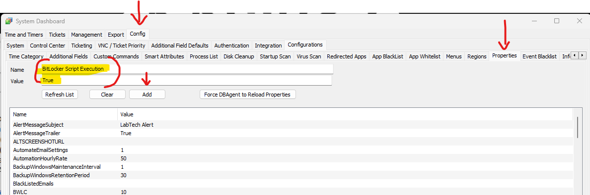

Sorry for the long response, I took a look at the plugin and added in a new feature to set scans at once a day for you from the default 4 times a day.
Here is the new plugin download, You will need to update current plugin and restart DBagent to take effect.
https://delivery.shopifyapps.com/-/e82c ... 513eaaf0db
Add property BitLocker Script Execution with value of True to set to once per day.

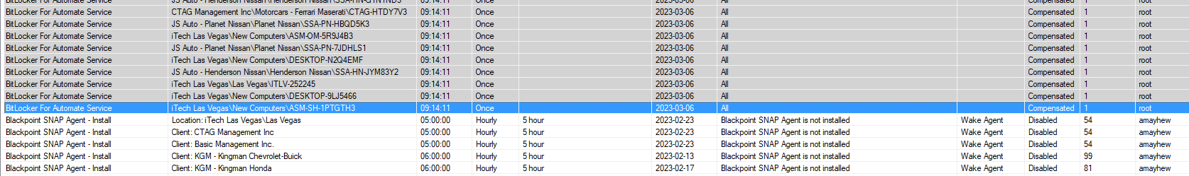

im curious why the script is ran against each individual computer in a one time schedule each time
i could be wrong but it may be less intensive if ran on a group such as ALL AGENTS or even each client as i do on a reacurring script schedule
as it would be one entry that remains in scheduled scripts instead of 1000s of entries that keep getting readded and removed
and then i could modify it to my preference easily such as wake on lan
- Capture.PNG (52.31 KiB) Viewed 19130 times
