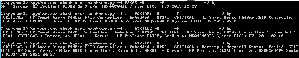

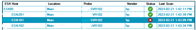

I also ran the script manually again on all 4 servers and all of them show the correct results except it's not showing correctly for 2 out of the 4 servers listed in the VMWare ESX Health Monitor window.
Screenshot 2023-02-21 135731.png (18.86 KiB) Viewed 104477 times
ESX05 and ESXi101 are showing the correct status but ESXi102/201 both have battery issues but show okay.
Though the script is showing the correct value so maybe we need to clear out the data table like we did for ESXi101 as that one does show the correct status?

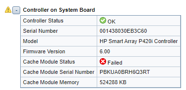

I've delete the data from the cim data table for the 4 devices in question and 2 of the 4 are reporting okay but other two are not.
This is me running the script manually and as you can see 3 out of the 4 are returning an error.
Screenshot 2023-03-01 161757.png (20.85 KiB) Viewed 104400 times

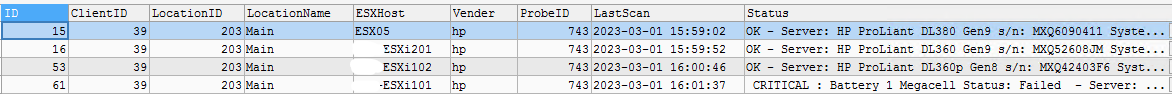

When I check the plugin_p4l_vmware_healthmon_hosts table it shows 3 out of the 4 have no issues, this does not line up with the script that I ran manually.
Screenshot 2023-03-01 161801.png (53.86 KiB) Viewed 104400 times
The CIM data status for the 4 devices do match with the status as shown in the screenshot above which matches the status in the client VMWare ESX Health Monitor screen in Automate.
Why is it not ingesting the failed status into the hosts table and cimdata table?
I might be able to get you the output details from when the Automate script runs if that would help though not sure if that gets us all the details.

I added the extra line into the script and when I tested it, the results match what the script is producing so it's not an issue with ingesting the data, at least not that I have been able to detect.
Now I have a different issue :(
The Python script isn't detecting the correct state anymore. I did try to restart the VMware management agent services but that didn't make a difference.

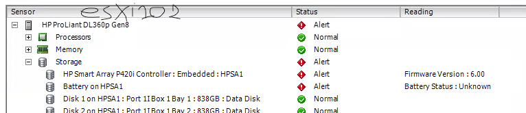

When I run the exact same cmd on the same servers that still have the hardware issue as before, it now returns status okay for 3 out of the 4 servers! :shock:
In the vSphere client it does show the correct status so now I'm confiused on why this is happening.
I did double check that we use the latest version of the script and that's indeed the case.
Here are the snipits for each of the stages and it looks like the issue is with the script.
Is there anything else we can do other then maybe running a debug on the Python script or restart the servers?
