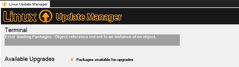

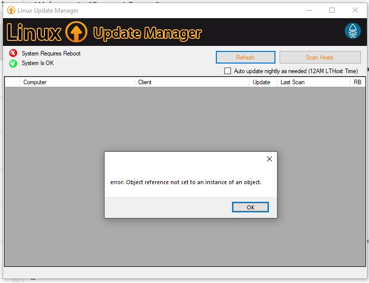

I followed the instructions located here to install the linux patching plugin in Automate.
https://www.plugins4automate.com/pages/ ... to-labtech
However, upon reloading DBA plugins, I never get check marks in "DB Loaded" or in "IIS Loaded".
The plugin config screens in automate just throw errors that say "Error loading Packages - Object reference not set to an instance of an object"
What have I missed, or how can I begin investigating the issue?
Thanks!

Newly installed plugin doesn't seem to be loading the DB
- Capture.JPG (48.48 KiB) Viewed 16946 times
- Capture1.JPG (28.54 KiB) Viewed 16946 times
- Capture2.JPG (15.74 KiB) Viewed 16948 times
Re: Newly installed plugin doesn't seem to be loading the DB
You should do 2 things after any plugin install
Restart the DBagent and log out and back into the control center.
After doing thing are you still having issues?
Hey, I was able to resolve the DB loading issue. I found that when I initiated a DB restart from the automate client, the client would report that the db was successfully restarted, but it was not, in fact, restarting. I logged onto the connectwise automate server and manually restarted the DB - that worked fine. I also remediated the cause of the db restart issue.
We are now facing another issue though, whereby after updating a server the LUM maintenance script fails to run, and the reboot update status is not updated after a kernel update. Here are some of the logs from the failed scripts:
The Script(5997) failed in the Then section at step 81. The reason: SQL Execute failed processing query
