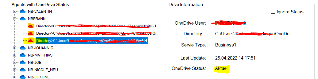

we have recently installed the Habitat Plugin on our Connectwise Automate Server primary to Monitor
the Status of OneDrive Sync.
After installing the plugin the Devices with OneDrive installed and working Sync are showing up in the Plugin
but the Plugin is reporting an error but the Sync Status reported in the Plugin is fine.
Maybe this has something to do with the PCs inststalled with German Language and the
OneDrive Status reported in the Plugin is also German.
Is there a way to fix this issue?

It looks like you are getting the status info though so I suspect it maybe a test we are doing in plugin.
Re: Habitat OneDrive Sync Status
I have managed to make some changes to that tool so that you can change the phrase used to match successful status.
You will need to upgrade to the build 1.0.1.23
Open the SQL Analyzer tool in Habitat and execute the following. (in your case)
REPLACE INTO plugin_p4a_habitat_properties (`Name`,`Value`) Values('OneDriveStatusText','Aktuell')
The default is 'Up to date' but now can be over ridden by this property existing in the habitat properties table and having a value greater than null or blank.
I will have build released sometime today.
