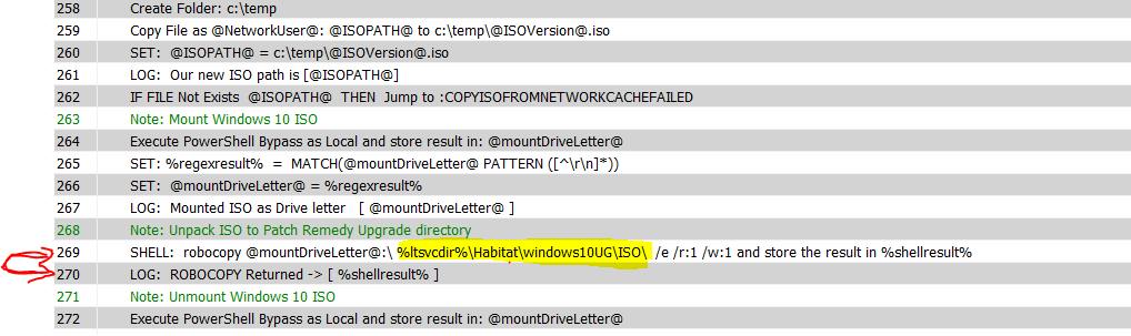

Hmmm..
Well the first thing I see is the following does not look right.
Started : Wednesday, February 2, 2022 1:57:57 PM
Source - C:\Windows\system32\Mount-DiskImage\
Dest - C:\Windows\system32\:\
Files : Missing
It should be pointing to c:\windows\ltsvc\habitat\ and it seems to be pointing to c:\windows\system32
This maybe a default fall back is the mounts to the ISO failed.
Below is where in the script your at when the script goes south. The first things to check are does the ISO exist on the local agent now? Did it successfully download? If it is there is it complete? same file size as original? and if so can you manually mount the ISO on that agent?
These are all the things that have to happen for robo copy to work.
Re: Windows upgrade assistant failure when pushing Win11 upgrade ISO
$mountResult = Mount-DiskImage -ImagePath @ISOPATH@ -Passthru
($mountResult | Get-Volume).DriveLetter
Replace @ISOPATH@ with you ISO file location and file name and execute in powershell to see it mount ISO and pass back a drive letter.
This is where I believe your going south. It is most likely failing to find file so mount ISO fails on line 264.
On line 267 it logs the drive letter, do you see that log in your script logs? should be just before the failed robo copy log you posted here.
