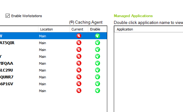

I don't have caching enabled but I assume thats not needed anyhow since these guys don't have common storage onprem.

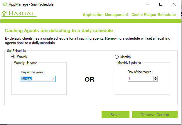

I don't seem to be able to get things on a daily schedule (for testing). the remove button doesn't do anything.

Problem # 1
"I don't have caching enabled but I assume that's not needed anyhow since these guys don't have common storage onprem."
After reviewing the document for this I failed to find where it stated that a location drive is mandatory so I have corrected this in the document.
In the document it reads at the bottom.
The heart of the system is the ability to use cache drive locations to feed the mass of agents while having just one agent actually stepping out on to the internet to manage the cache at each location. This saves time and energy it would otherwise take to allow each agent at the location to download the same packages repeatedly. This also prevents exceeding the community repository limits and causing agents to skip installs and updates.
Choclatey.org has really locked down the community repo to excessive requests so as you may have noticed in to original version many clients went uninstalled because of this. We tried creating some staggering of installs and setup the ability to slow installs but still saw limit reached regularly. We needed a way to deliver without exceeding limits and do it consistently. The only way is to limit the number of agents making requests from chocolatey.org. This means we needed to be able to pick an agent as the speaker of the network location and then collect the packages and allow for local distribution and install/update.
The caching drive does not need to be a big investment. Any workstation that can afford 1.5GB of drive space could supply the space needed to cache the packages for local deployment. Does not require a NAS or server share to function, just a location all agents can touch via the network. Making sure the permissions on the share are correctly set is typically the biggest issue. See the help document towards the bottom for the configuration set how-to.
We have heard from several customers that this is not used and or is not setup for use. We see it as a Client onboarding process that is best practices. By pre configuring a local share at each client you onboard and setting up this caching location allows tool through out Automate to utilize the caching nature of the location and will be reflected in the decrease in bandwidth used by Automate processes. It is a one time set that should allow the automation of patch management for your clients deployed software and allows you to quickly deploy new application. A good solid trade off for feature improvement.
Second Issue
"I don't seem to be able to get things on a daily schedule (for testing). the remove button doesn't do anything."

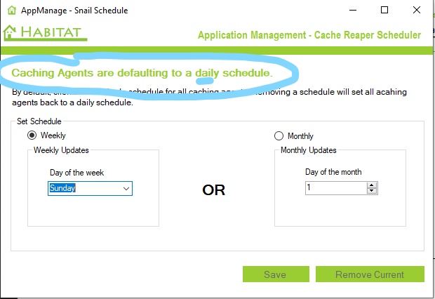

This tells you what is currently set, as you select and change dates or use the remove button, this text should change telling you if you are set to weekly or monthly else the default is daily as stated. The remove Setting changes this text back to the Daily is the Default text and sets the system back to daily. Otherwise the text will say monthly or weekly based on what you save.
You are not the first to be a bit confused by this. I will look at this and see if we can change the behavior so it is more apparent which of the 3 settings is currently active.
Inkedhabitat 2_LI.jpg (898.29 KiB) Viewed 16894 times

For the schedule, I see now..if I hit save then I would have had a weekly schedule but since the buttons were greyed out, it was a daily schedule.
