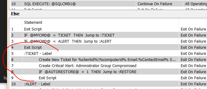

Re: Habitat Local Administrators group Monitor (LAGM)
The tickets are created inside the LAGM script inside the scripts\maintenance script folder in Automate. There is a sub function in the script that when called from script creates the ticket. You can edit this function changing the values where it creates and modifies the ticket.
Post by JvdMaat »
Is there a way to rethink this and have tickets/alerts created from an actual monitor?
We use CW Manage PSA integration, and use CWM for our ticketing.
But not all CWA tickets go to CWM. We do it based on the Ticket Category. And we've found we were unable to set the Category on a script-created ticket (If you adjust the category after ticket creation, that does not affect the CW Manage plugin. So the ticket has to be created with the correct category). So these LAGM tickets live in Automate only where we won't see them.
Having this be on an internal monitor (with a SQL query against the LAGM Habitat table maybe?) would allow us to set this to an alert template and ticket category that will send it to our ticketing system.
(It would require a bit of retooling, as the autorestore is built into the ticketing/alerting. So you'd potentially lose the ticket when you have autorestore enabled. (Or just get the CWA ticket/alert)
