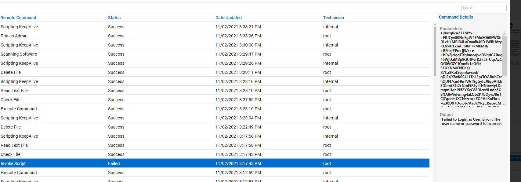

I am having an issue with the script running on Computers, looking at the command, the script is saying failed to login as user. Error : the user name or password is incorrect

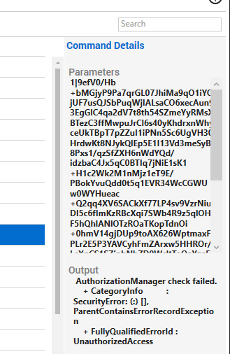

If i change the script to run as local instead of run as admin i get the below error
Run as local.PNG (32.57 KiB) Viewed 17696 times
So far running as admin 3 computers have shown out of 60 and have successfully run, the others are failing.
Can anyone let me know why its failing on the rest?

Running as the local user does not have permissions needed to query the local administrators group via POSH.

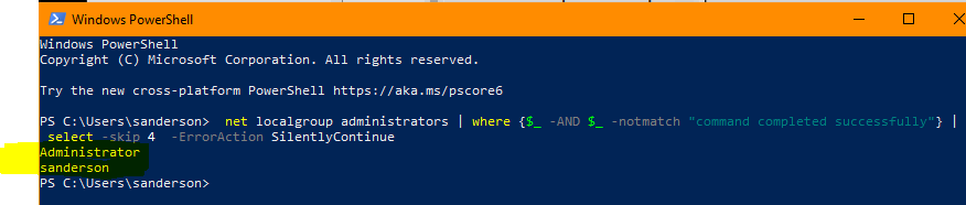

 net localgroup administrators | where {$_ -AND $_ -notmatch "command completed successfully"} |  select -skip 4  -ErrorAction SilentlyContinue

Should look a little something like this,
Execute this inside of a command prompt inside the control center on an agent and see what you get. If it works then you need to make sure the script is set to use either "shell execute as admin" or "Shell execute Enhanced"
