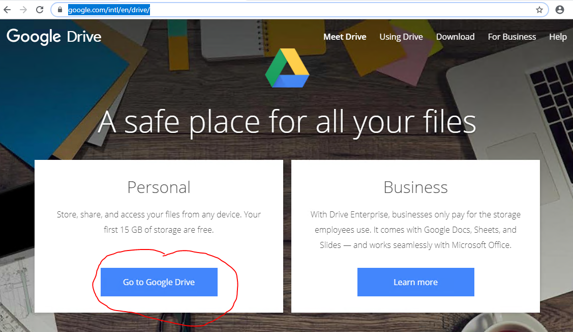

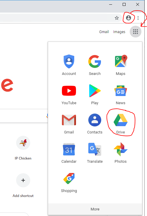

It's a good idea to launch in to Chrome (not required) as your browser and select from the top icon the drop down menu to launch Google Drive. Otherwise visit google.com and search for Google Drive.
Now assuming that the browser is not "logged in" as a Google User already and if so log out and re-run the step above. You should see the following web page in browser.

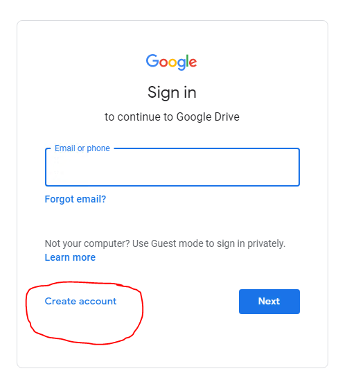

Select the personal account option to be presented with a "Sign In" dialog.
Use this dialog to select the create new account link. Create your new account and complete the initial account setup process. Afterwards it should return you to the following webpage.

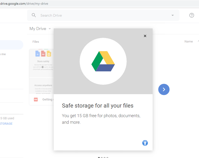

You should now be in your new Google Drive account looking at the default view. Inside this view you should see a single "Getting Started" file. Do not delete this file yet. We will be using it later in this example.

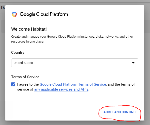

This will prompt you to accept the TOS

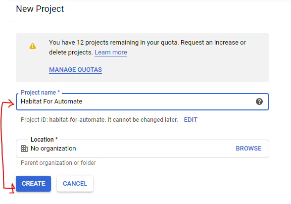

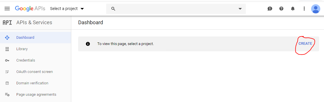

Once you agree to the TOS Create a new project called "Habitat For Automate" by selecting the create link.
Put in the project name "Habitat For Automate" and Create.

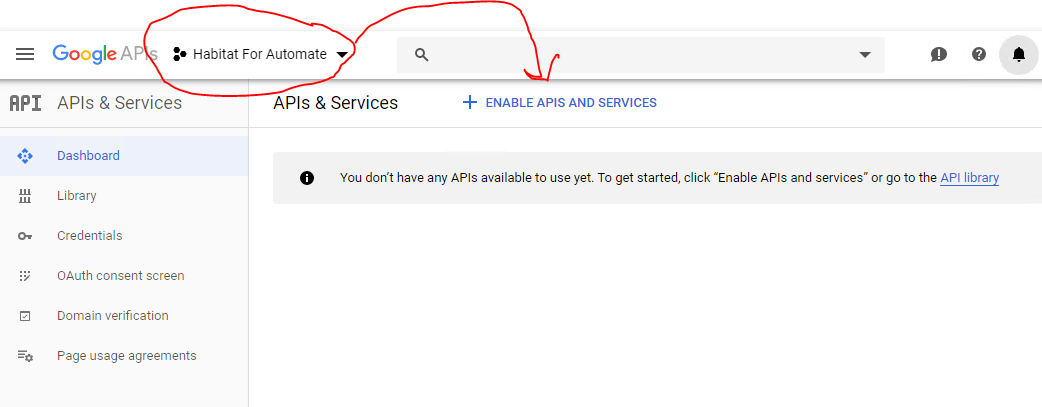

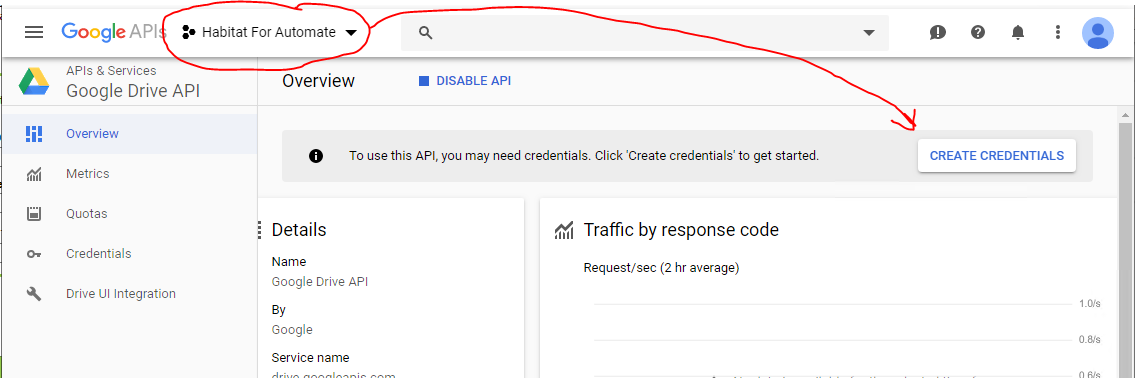

We should now be inside our project, see the top of the web page for project name to be listed. Then select the link "Enable APIS and Services". This will allow you to add the Google Drive API to your account.

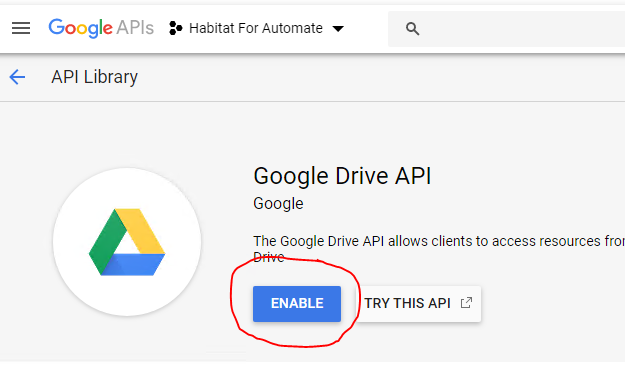

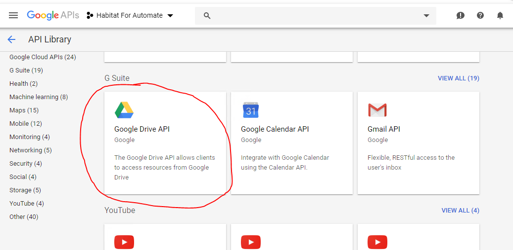

Find and select the Google Drive API (under G Suite).
Select to enable this API

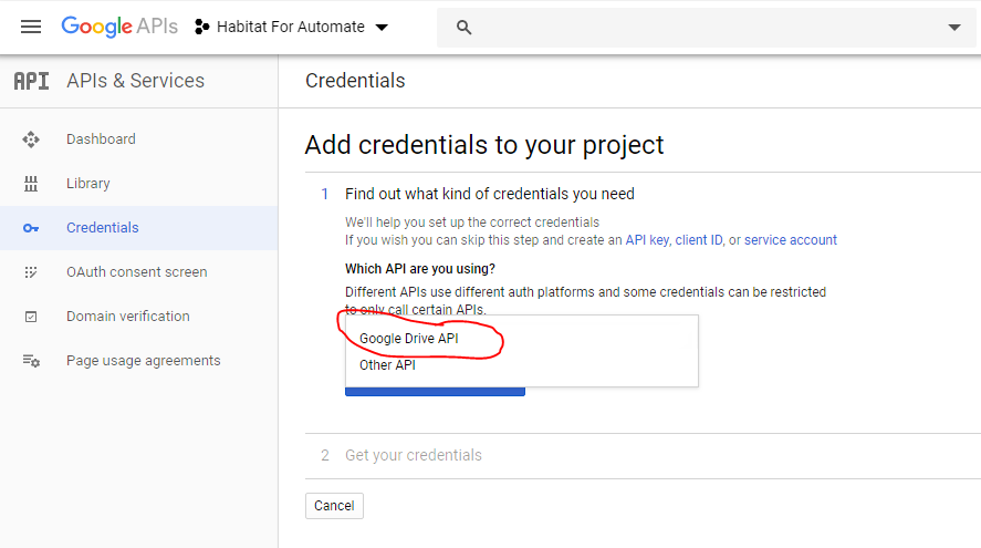

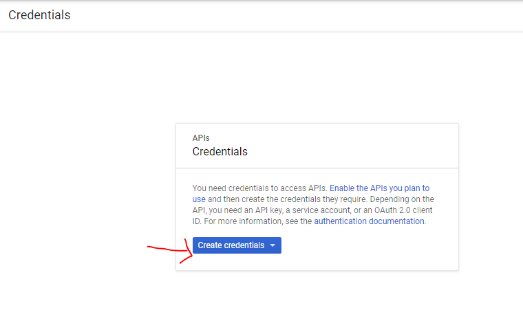

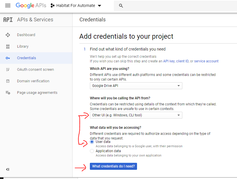

Now we need to set up security for our project. Select the "Create Credentials" link for project.
First select to add Google Drive as the API.

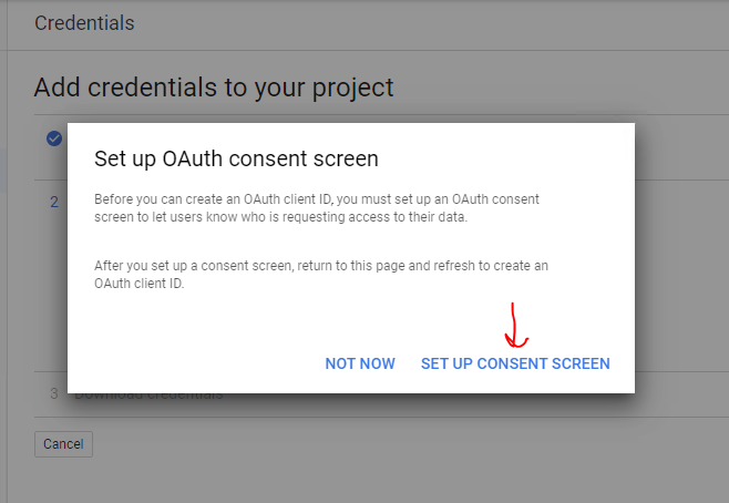

Now select "Other" and the "User Data" radio button. Click the "What Credentials do I need" to continue.

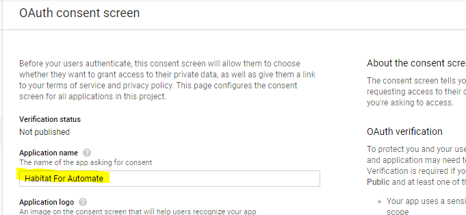

Select to setup Consent Screen.
Fill in the "Application Name" with Habitat For Automate

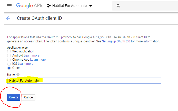

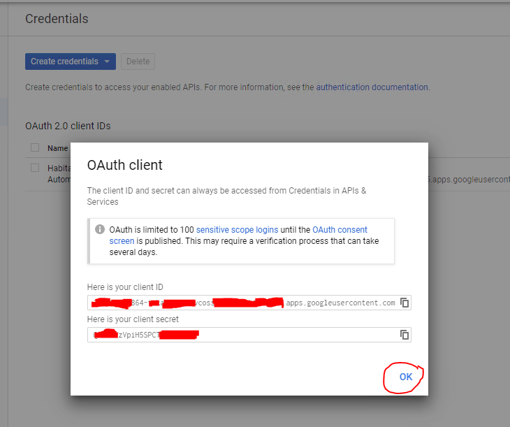

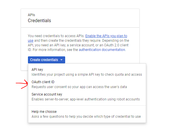

You will be presented with the following screen, select "OAuth client ID".
Select the "Other" radio button, type in the name "Habitat For Automate" and select create.
It will present you with a long URL string as a client ID and a secret key.

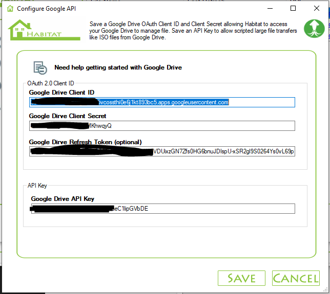

Save this Client ID and KEY safely. You will take that information and inside the Habitat plugin. Select the Configure button in main menu of the Habitat plugin to input this info.
Configure Habitat Plugin
On the Habitat Control Center tab you will find the Google Drive plugin icon. This will launch the Google drive file manager. From this window you can select Configure Access to add in the newly created keys and authorizations.
You can take your new ClientID and Key and add it to the plugins configuration.

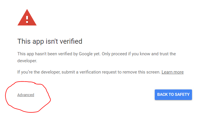

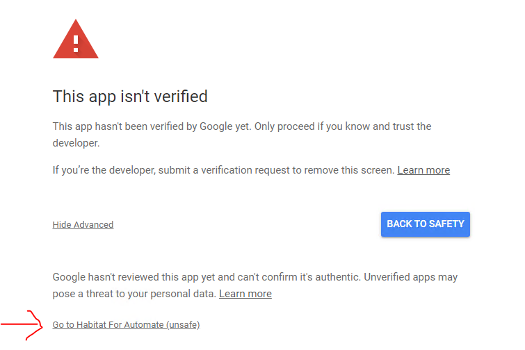

You will get a warning that the API Creds you are using (ClientID) is not verified. It belongs to you so you know its safe.
Select to expand the advanced link to accept responsibility for the ClientID credentials your providing.

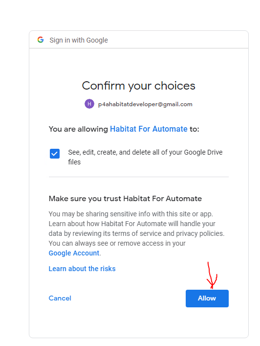

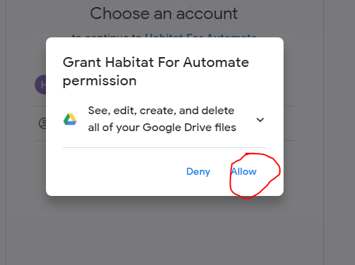

And then select the Allow when prompted.
And Again confirm your choice.

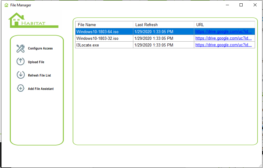

Now remember that Getting Started file we left in our google drive for later? Yeap, we are now going to use that file to confirm that we are indeed connected and working with Google Drive. Select to Refresh File List
It should come back pretty fast with an update showing you that one file in your google drive currently. it will also allow you to download that file or remove it if needed. This data is now in the Automate database for you to access when needed.

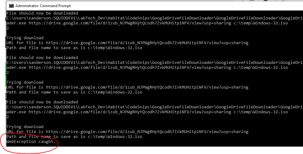

I seem to be having issues downloading anything with Habitat-GDLFD. It runs the command and it finishes instantly. Is there any way to debug what's going on? It can't seem to download small or large files.
edward.cossett
Posts: 11
Joined: Tue Feb 11, 2020 4:23 pm
Re: Enable the Google Drive feature in Habitat
Post by edward.cossett »
Upon further inspection, it seems when I uploaded the ISOs into the Drive, I needed to enable link sharing. That has fixed my issues. Using the API key, I can download the ISOs now with the Upgrade Assistant! I used postman to try and "get" some other files that I had in there. Postman could only see the Large File Downloader. When I noticed it couldn't even see the getting started file, I knew it was probably related to permissions in Google Drive.
