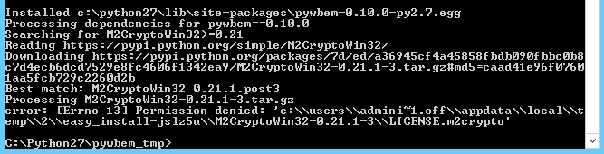

C:\Python27\pywbem_tmp>C:\python27\python.exe .\setup.py install
Result
Installed c:\python27\lib\site-packages\pywbem-0.10.0-py2.7.egg
Processing dependencies for pywbem==0.10.0
Searching for M2CryptoWin32>=0.21
Reading https://pypi.python.org/simple/M2CryptoWin32/
Downloading https://files.pythonhosted.org/packages/7d/ed/a36945cf4a45858fbdb090fbbc0b8c7d4ecb6dcd7529e8fc4606f1342ea9/M2CryptoWin32-0.21.1-3.tar.gz#sha256=5497e113980a5f7a925512168ed5e6fc5d9c858632c2953f010f0818a459e19d
error: Download error for https://files.pythonhosted.org/packages/7d/ed/a36945cf4a45858fbdb090fbbc0b8c7d4ecb6dcd7529e8fc4606f1342ea9/M2CryptoWin32-0.21.1-3.tar.gz#sha256=5497e113980a5f7a925512168ed5e6fc5d9c858632c2953f010f0818a459e19d: [SSL: CERTIFICATE_VERIFY_FAILED] certificate verify failed (_ssl.c:661)
So everything was mostly good until it tried to download the M2CryptoWin32. The error makes me think the firewall is to blame as i was able to copy the URL and download the package via a browser on my machine. Then for kicks i tried to download it through the browser on the target machine and the package downloaded fine. So i think could still be a firewall issue but unable to verify at this time.
Now i was trying to figure out where to place the M2CryptoWin32-0.21.1-3.tar.gz file so when i rerun
it might find the file already downloaded and begin working with it but i couldn't find where to put the file as numerous attempts failed with it unable to download the file.

copying build\scripts-2.7\mof_compiler.bat -> build\bdist.win32\egg\EGG-INFO\scripts
copying build\scripts-2.7\wbemcli -> build\bdist.win32\egg\EGG-INFO\scripts
copying build\scripts-2.7\wbemcli.bat -> build\bdist.win32\egg\EGG-INFO\scripts
copying build\scripts-2.7\wbemcli.py -> build\bdist.win32\egg\EGG-INFO\scripts
copying pywbem.egg-info\PKG-INFO -> build\bdist.win32\egg\EGG-INFO
copying pywbem.egg-info\SOURCES.txt -> build\bdist.win32\egg\EGG-INFO
copying pywbem.egg-info\dependency_links.txt -> build\bdist.win32\egg\EGG-INFO
copying pywbem.egg-info\requires.txt -> build\bdist.win32\egg\EGG-INFO
copying pywbem.egg-info\top_level.txt -> build\bdist.win32\egg\EGG-INFO
zip_safe flag not set; analyzing archive contents...
pywbem.mof_compiler: module references __file__
creating 'dist\pywbem-0.10.0-py2.7.egg' and adding 'build\bdist.win32\egg' to it
removing 'build\bdist.win32\egg' (and everything under it)
Processing pywbem-0.10.0-py2.7.egg
removing 'c:\python27\lib\site-packages\pywbem-0.10.0-py2.7.egg' (and everything under it)
creating c:\python27\lib\site-packages\pywbem-0.10.0-py2.7.egg
Extracting pywbem-0.10.0-py2.7.egg to c:\python27\lib\site-packages
pywbem 0.10.0 is already the active version in easy-install.pth
Installing mof_compiler script to C:\Python27\Scripts
Installing mof_compiler.bat script to C:\Python27\Scripts
Installing wbemcli script to C:\Python27\Scripts
Installing wbemcli.bat script to C:\Python27\Scripts
Installing wbemcli.py script to C:\Python27\Scripts
Searching for M2CryptoWin32==0.21.1.post3
Best match: M2CryptoWin32 0.21.1.post3
Adding M2CryptoWin32 0.21.1.post3 to easy-install.pth file
Using c:\python27\lib\site-packages
Searching for PyYAML==5.3.1
Best match: PyYAML 5.3.1
Adding PyYAML 5.3.1 to easy-install.pth file
Searching for ply==3.11
Best match: ply 3.11
Adding ply 3.11 to easy-install.pth file
Searching for six==1.14.0
Best match: six 1.14.0
Adding six 1.14.0 to easy-install.pth file
Finished processing dependencies for pywbem==0.10.0
build_moftab.py: Rebuilding the pywbem LEX/YACC table modules, if needed
build_moftab.py: Ensuring to build in pywbem install directory
Building LEX/YACC modules for MOF compiler in: C:\Python27\lib\site-packages\pywbem-0.10.0-py2.7.egg\pywbem
WARNING: yacc table file version is out of date
Generating LALR tables
WARNING: 4 reduce/reduce conflicts
WARNING: reduce/reduce conflict in state 61 resolved using rule (qualifierName -> ASSOCIATION)
WARNING: rejected rule (empty -> <empty>) in state 61
WARNING: reduce/reduce conflict in state 63 resolved using rule (qualifierName -> INDICATION)
WARNING: rejected rule (empty -> <empty>) in state 63
build_moftab.py: Successfully rebuilt the pywbem LEX/YACC table modules, if needed
Eureka. It completed successfully.
Now when attempting to scan the hosts they were successful in returning data.
I haven't slapped these commands into an Automate Script yet so i can run it quickly when i encounter it again but should be easy enough to accomplish. I haven't done this enough times yet to identify a common theme. I seem to see it mainly on Server 2019 so far but it could also be the firewalls we are deploying and if they are doing SSL Decryption somehow messing with it.. I also found it odd that when "pip install m2cryptowin32" executed it had no problem downloading the file (unlike the other command which failed to do so) but its possible it found it in the C:\python27 directory because i put it there in previous troubleshooting. I'll have to confirm that when i run into the next one that acts up.
Anyways hope this helps someone as its been a thorn in my side for quite some time.
