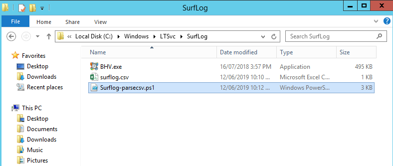

Hi, I have updated the plugin as advised, results are still the same empty csv is created and script fails at the same point
I did delete all the files in the Surflog folder and for what it's worth the newly downloaded BHV executable is timestamped July 2018.

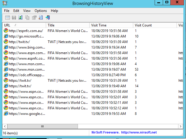

Re: Empty CSV file is created
k, now just manually run the BHV.exe file by itself. No switches just double click the exe file.
It will launch in desktop mode with a GUI which will allow you to exercise all the options available.
Start testing what options deliver a screen full of log data. Then send us a screen shot of thoes settings so we can see what your having to execute to get data from your Terminal server.
Typically on a terminal server the /HistorySource 1 switch says to pull data from all users so you should be seeing history by userid.
Some reason this is not the case and most likely its a permission issue some where but we need to confirm that. What browsers are installed? if you were to install another browser and surf a few urls does that data show up in the scans?
Might be a browser specific issue?

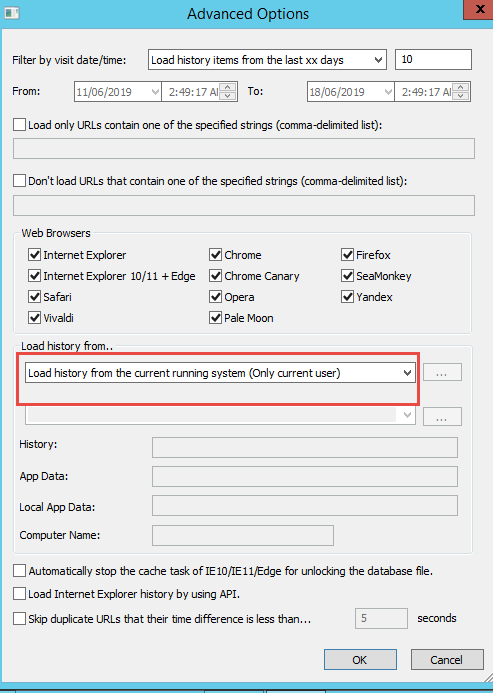

It appears that I can only retrieve data for the current user, using the settings below, not for all users
Surflog 2.png (61.5 KiB) Viewed 29678 times
Surflog 1.png (33.33 KiB) Viewed 29678 times
