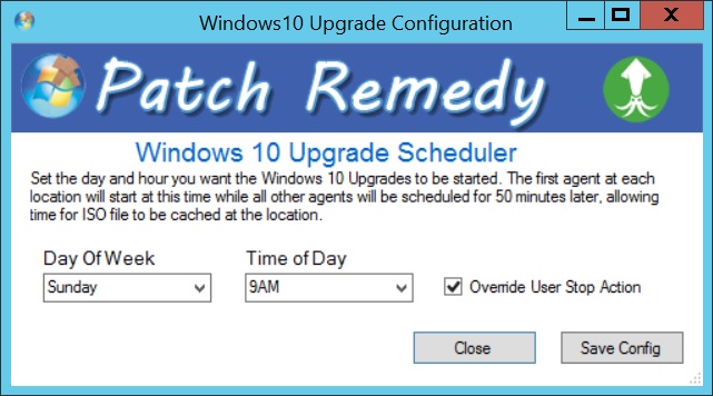

I had configured the schedule with over 24 hours advance notice. I attached the logs, they do not appear to show PR scheduling scripts for the auto enabled computers at that time from what I can tell.
Configured time was for 9am on Sunday.
Let me know how to proceed.
Thanks!

- Patch Remedy Windows 10 Schedule Configuration.jpg (77.12 KiB) Viewed 12086 times

So I ran the queries and the Day of the week, Time of Day and Agents it should be scheduled for does line up.
0 = Sunday
9 = 9am
At this point just 1 agent set for auto upgrade schedule for testing came back in the query. I'm not going to mess with the scheduling in PR and we'll see if the script kicks off this Sunday as expected.
I looked at the agents currently scheduled scripts and there is nothing PR related scheduled for Sunday, Dec 23.
I assume changes to the schedule and changes to agents enabled for auto deployment are stored directly to the tables right as they are changed.
Can you tell me when PR plugin will schedule the script and how often it goes through this process? Then i can look and see if the script has been scheduled as expected.

Patch Remedy is checking to see when it is 9am on a Sunday. When that time frame hits it schedules the script to run instantly. So script should be scheduled on or around Sunday at 9 am. That is why we want the logs for that time frame as it will show the sever setting the schedule then.
