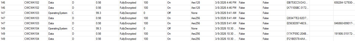

In the BitLocker plugin, is it possible to add the Encryption method as a column on the volume output, so for auditing purposes, we can see if it's running 128 or 256? For basic use, 128 is fine, but some financial firms require 256, and they need a report that includes that field. I was wondering how difficult it would be and if it would be possible to add that field.

Ok, it's now available in build 1.0.0.22
Download 1.0.0.22 Here
Update the plugin, Restart your DBagent and allow a minute or so (depending on computer counts) for DB to complete the updates. Relaunch the Control Center and you will now have a new column. Allow time for computers to do their next BitLocker scans and the data will update in that column.
