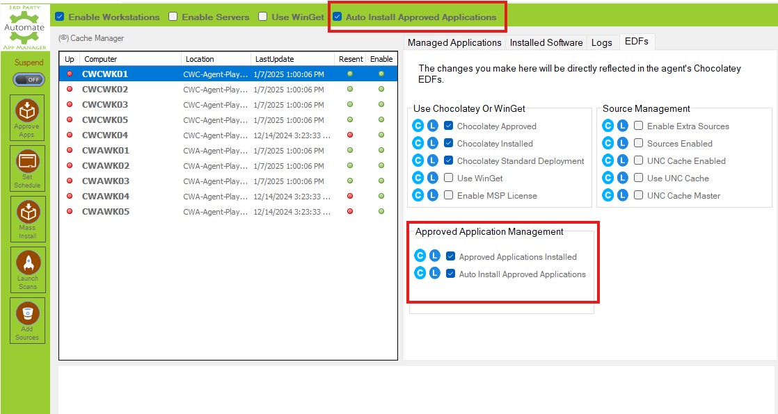

I have enabled the new App manger with Winget in Habitat 1.0.1.48.
I have enabled Chocolatey Approved, Chocolatey Installed, Chocolatey Standard Deployment and Use Winget on all workstations on 1 site. Which was the recommended setup for using Winget.
How do I now just update apps for eg, 7-Zip and Notepad++, but not install the app if it is not installed. I understand I need to add the winget versions of the apps into the application list. Do I just enable the app in the list?
I am a bit worried that I may push out/Install an app to all workstations/servers by accident that is not required.

If you do not want to have applications auto install when not present on agent. Make sure that at the client level the Auto install box is uncheked. You can then verify any agent by looking at the edf's for Auto install and verify they are unchecked. If the state of unchecked is true then no packages will be pushed to agent. Enabled or not. Enabled at the client level will allow packages to be manually pushed via the plugin is no automation is selected.

Will enabling just "Approved Applications Installed" only. allow updates to approved apps to be pushed out?

They work together but only if the Auto Install Approved Applications is checked first. Then if the "Approved Applications Installed" is checked the system will believe the job was done and completed. No new action on this agent will take place until somthing in the environment changes. At which time the environment will uncheck "Approved Applications Installed" which if the agent has "Auto Install Approved Applications" checked, the system will force agent to retest all currently installed applications against the current Approved applications list. If there is an application missing on the agent, the agent will install the new application and after completion will recheck "Approved Applications Installed".

Arr ok thanks, got it the wrong way around. If I tick these options as you have previously said will it also install the approved apps if they are not there. Which I am trying to avoid.

We will always update what ever applications have been installed through Chocolatey. So if you do not check to auto intall approved application the the plugin will only update and not install. If nothing is installed on agent it will update nothing. If agent has previous installs or manual installs then those will be updated during normal update schedules.
