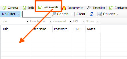

This control is looking for the "Title" you gave to the username and password set under the clients passwords list in Automate.
Screenshot 2024-11-07 104150.png (9.8 KiB) Viewed 8815 times

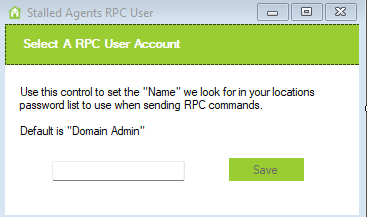

It defauts to "Domain Admin" if none is given. But if it does not exist here it will of course fail. So set a user that can force a RPC restart of the agent service and provides its title here so we can find it when you execute the RPC call.
Screenshot 2024-11-07 105232.png (13.33 KiB) Viewed 8815 times
