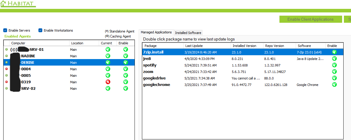

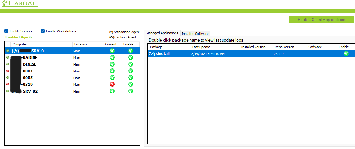

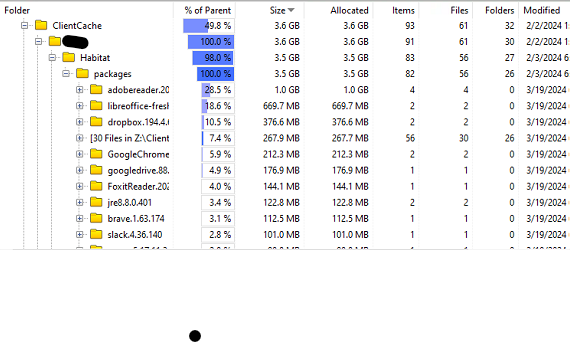

We've been working on getting cache drives setup in Azure so that we can still use Habitat Apps Manager for all of our devices. I believe I have the Azure share configured properly, as I'm seeing cache files & Habitat folders in the share where I'd expect them.

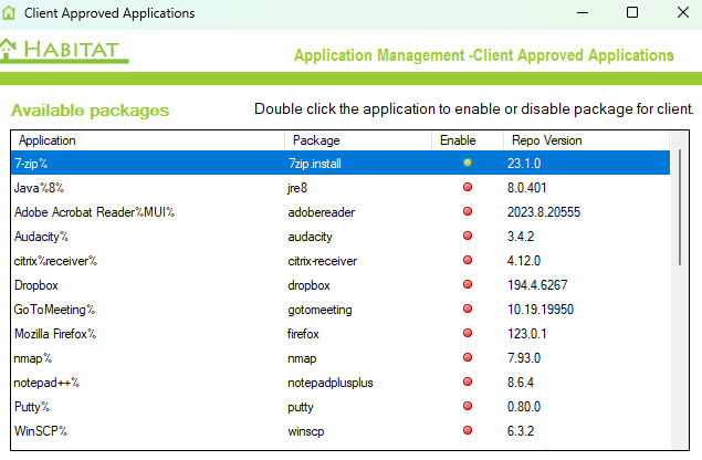

Most all devices in our test client are showing a green check next to Current now, but they don't appear to be current. (The 0319 device has been offline all of 2024, so not worried about that one.) The apps that aren't enabled for the client have not been kept up-to-date (see first screenshot). The one app that we did enable for this client (7-zip) did not get installed on computers that are missing it (SRV-01 and NADINE). I got this setup several weeks ago and let it sit for a while, so I feel like it should be humming along at this point. Any ideas where we can look to troubleshoot?

Heyo, actually it looks like we still might be having a prob updating apps :/
Any apps that we've enabled for a client do seem to stay updated, and they seem to roll out to devices that don't have the software. So that's fantastic, and a huge step forward for us, and very awesome!!
But apps that we don't have enabled for a client don't seem to be updating still. When I look at script logs, the only software that's mentioned in the logs are software that we've enabled for a given client.
Looking at Adobe Reader, for example. We have that listed in our overall catalog, but we don't want to roll out Reader to all devices. We just want to keep it updated on any device that already has it. It looks like it's still running a super old version on CT-3410, and none of the script logs seem to mention Adobe at all. They do mention 7-zip, notepad++, putty, and the others that we have specifically enabled for this client.

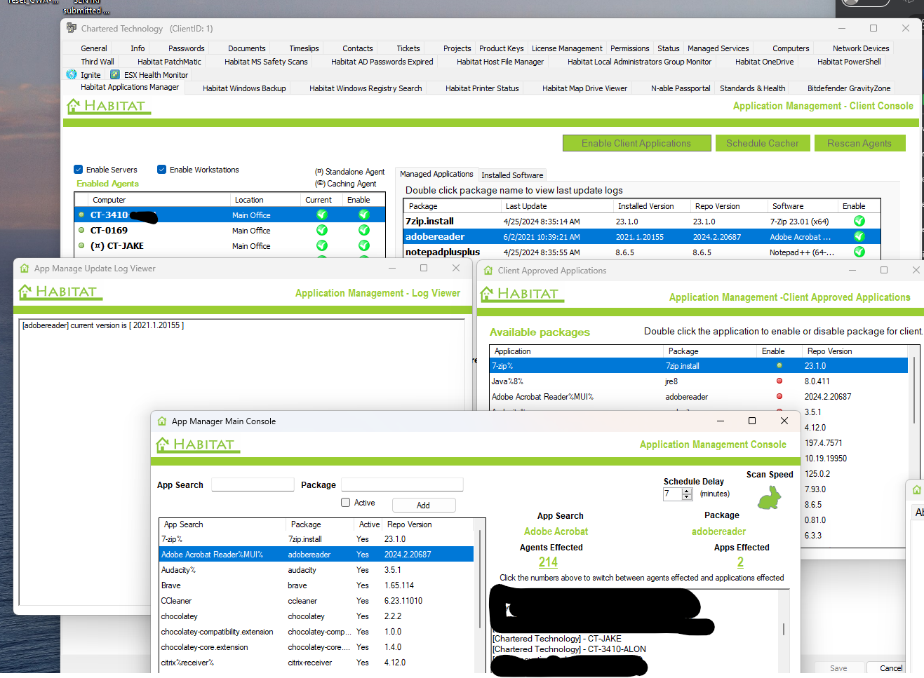

Screenshot 2024-04-25 151824.png (273.69 KiB) Viewed 18037 times

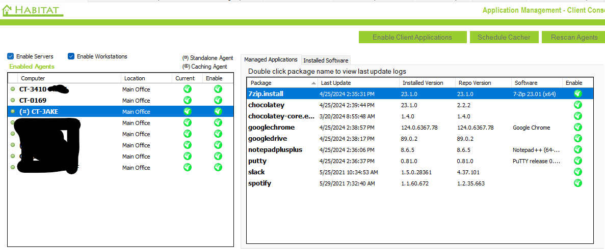

Interestingly, though, if I look at CT-JAKE, Adobe Reader isn't listed in the list of Managed Applications at all. But it is in the list of Installed Software. And I did just confirm I do have Reader 2021 installed on this computer.
Screenshot 2024-04-25 152105.png (65.88 KiB) Viewed 18037 times
Is that expected behavior? Are we able to use this plugin to keep existing apps up-to-date, regardless of if we want to deploy them to all devices?

Re: Applications Manager Devices Not Updating
Good Post!
In Habitat, This is the expected behavior.
Reason:
When Habitat manages updates of packages it does it one by one and does not just call "choco update all -y". It gets a list of approved apps from the client and loops through those apps, updating each app by name. This allows the function to capture outputs from each call to determine if errors exit for a particular package.
Habitat's Application Manager was derived from the Chocolatey 3.0 plugin back when Habitat was first conceived. Its processes and functions are based on that framework and is a bit rigid. We made big strides with Package Management in general since the original release Chocolatey 1.0. Today we are currently servicing Chocolatey For Automate 3.6 and our latest plugin to hit the stage, Automate Package Manager, which takes our Chocolatey framework and applies it also to Homebrew (Mac) and Apt-get (Debian/Ubuntu Linux), YUM (RedHat, CentOS, Rocky Linux) and Zypper (SUSE Enterprise, OpenSUSE Linux). We also have introduced Update and Install policies along with a more robust scheduling service. We also greatly improved the delivery of the automated services by moving most of the automation out of ISYNC and in to Group management. This means you as the MSP have more control over when and how often any automation takes place in your environment. Essentially allowing you to "tune" the plugin to your environment.
Here is a video demo of Automate Package Manager. Youtube Video
As for your second question:
Any software that shows up in Software List comes from the Windows (Installed Apps) list and not from Chocolatey scans. Only software installed by Chocolatey can be directly managed by Chocolatey. Chocolatey does not go looking for installed apps on windows and then associates some repo package as its equal. Chocolatey must install a package to be able to maintain that package.
In CT-Jake case, to get Chocolatey to manage the Adobe, add Adobe to the approved apps. It will install it's Adobe reader package. This may cause there to be 2 Adobe versions installed, Adobe may see previous version and replace it, or may not. If it does not, you will need to manually remove app from Windows, or not.... (up to you).
