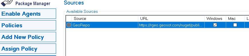

This is exactly what i cannot explain... How am i getting the chocolatey.rrmmax.com. i never set this up.
See screenshot to where my source is pointing...

Ok that's a twist! Let me have a look at our code to see if we left a hardwired variable in the mix. There maybe a line that didn't comment out during build.
I'll post in the am tomorrow
Re: Client Console- Update Specific Package
Sure enough, someone (likely me) left some test data in the Deploy Sources script. So no matter what or how many sources you have it always used the same test data and not your live data.
I have fixed this in 1.0.0.14 available here https://delivery.shopifyapps.com/-/4364 ... 7335440336
Update date your plugin, restart the DBagent and relaunch your control center. Afterwards you should have a APM Deploy Source script with a version # of 1.0.0.14.
Now, to clean everything up and get your sources corrected you will need to allows the Deploy Sources to execute again on agents.
You can just assign the script to a group of agents manually and it will correct the issues or you can allow automation to do it. For Automation to re run the source deployment script on agent requires the EDF for that agent that says Sources were deployed to be unchecked. You can go uncheck that the source was deployed in the APM EDFs or if you want to script it. You can create a script that executes this SQL for every agent you want to have re deploy sources.
This will cause the (Sources Enabled) EDF to be unchecked for agent running script.
REPLACE INTO extrafielddata Values('%ComputerID%',(SELECT ID FROM extrafield WHERE Name = 'APM - Sources Enabled' and `Section` =  'Automate Package Manager'),'0');
