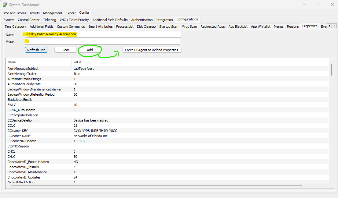

You will now be able to set in the Automate properties one of 3 properties.
Weekly Patch Remedy Automation with a value of (0-6) Sunday - Saturday
or
Monthly Patch Remedy Automation with a value of (1-31) day of the month
or
P4A Patch Remedy Automation with a value of 1 for once a day scans only.
Screenshot 2023-06-05 100435.png (48.01 KiB) Viewed 28583 times
If you place any one of these in the properties of Automate and refresh the DBagent as shown in image, then Patch Remedy should start adhering to that schedule. If you place more than one property then Weekly will dominate followed by monthly and then once a day. so depending on how many properties you have set only one schedule will actually run.
