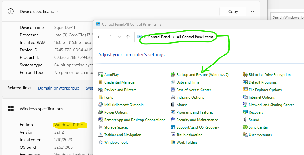

Ok so here is the skinny.
Works on both 10 and 11 with out issue. If you have Windows 7 Backups turned on in available settings.
The plugin works off of the wb-admin.exe tool provided by Windows backups. If you are using the Azure backups then there is a different client for that and not apart of this plugin.
If you can execute wbadmin.exe GET Versions with out error then our plugin will read the agent and update scan statuses in plugin.
Here is an excerpt from our scanning powershell script that captures that data. Try opening a admin ISE powershell console and pasting the code in. Execute it and see if you do not get a return from it.

The Windows 7 backup tool is under all control panel items as seen in image below..
Screenshot 2023-01-18 134352.png (83.77 KiB) Viewed 29180 times
