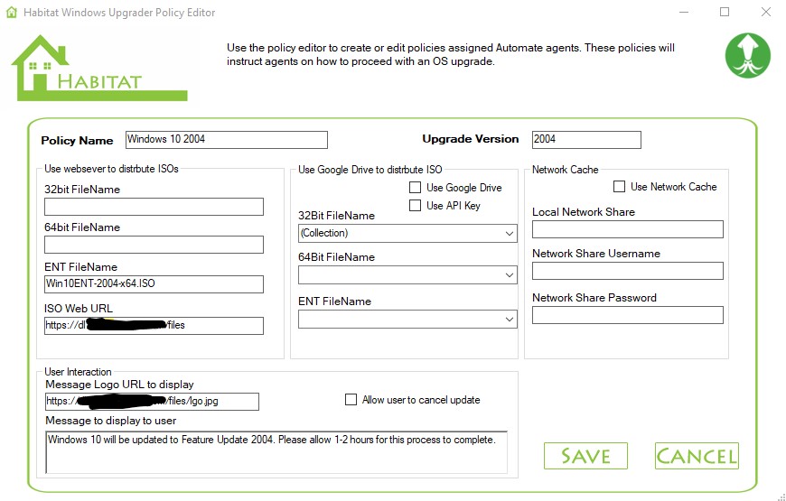

Please post screenshot of your policy for the installs
Screenshot 2021-05-10 103254.jpg (96.74 KiB) Viewed 7654 times
I've tried with both the ENT iso listed or the 32/64 bit iso's, same result either way.
Re: WIndows Ugrade Assistant - ISO download failure
Posted: Tue May 11, 2021 1:53 pm
Ok so by your config I see your only downloading Enterprise Windows 10 and neither the 64 or 32 bit versions of PRO.

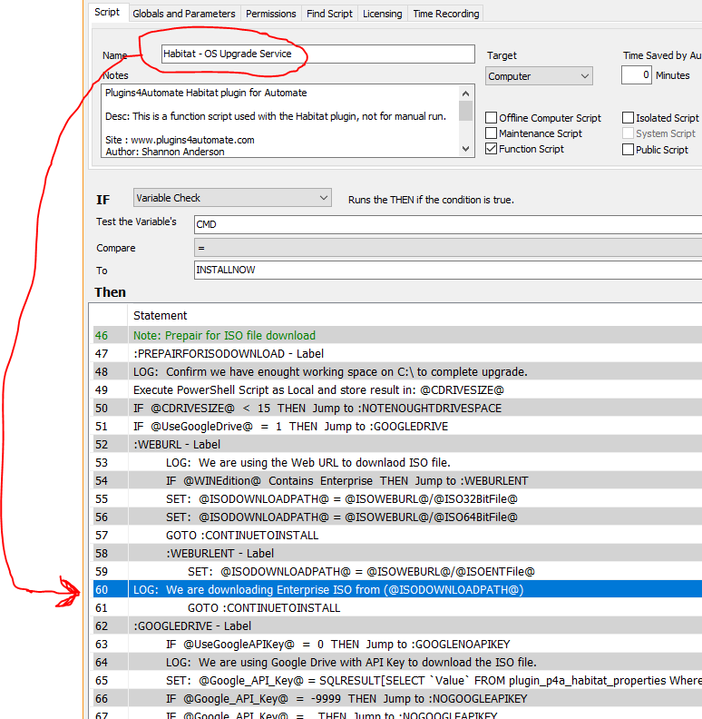

To test this theory, lets open the Scripts\Maintenance\Habitat - OS Upgrade Service script and in the "Then" section lets add a new line at line 60.
The new line should be a "script log message" function and place in the log line the variable "@ISODOWNLOADPATH@" which will print out the URL it will attempt to fetch.
Lets see what it logs as a URL to see if it got malformed in some way.
You should now get a log message during the running of script that will print out this URL.
Between Line 52 and 60 we construct the URL from the entries placed in the configs for 32 bit, 64 bit and Enterprise. If for some reason your grabbing incorrect data then URL will be malformed here and we should be able to see that in the logs during an update attempt.

Sorry for the delay. I added in the two empty .iso fields and it worked. Just wanted to close the loop on this. Thanks for your help!

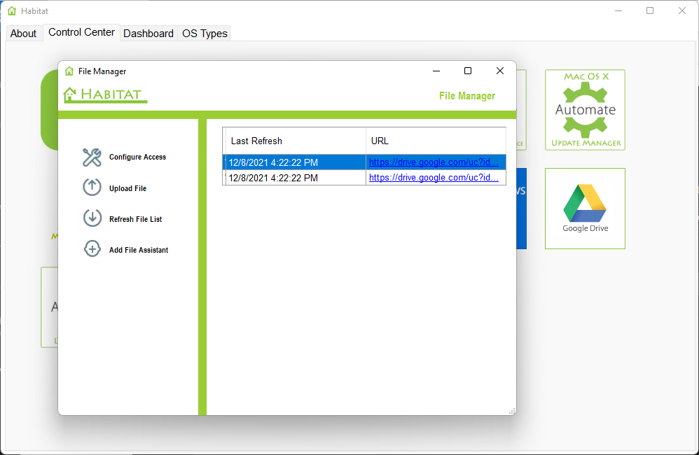

I'm having a similar issue where the download fails but I'm using the Google Drive API. It's seeing the files, but if I try to download the file from the Google Drive File Manager I get Access denied?
Did I possibly miss something in configuration steps again?
Thanks in advance

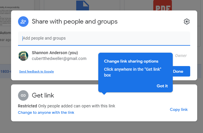

Sounds like your issue is with the uploaded file permissions. Go into Google Drive and allow it to be shared by only the link and not restricted to users.
Posted: Thu Dec 09, 2021 4:54 pm
by NinjaMonk
That was it thank you very much file is now downloading :D :D :D :D
