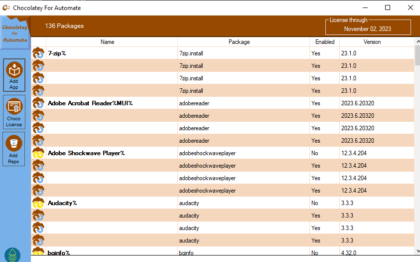

Search groups are there now, but things are broken...
Managed apps appear to have unapproved apps, and all look like they are listed twice.
KB updates are also listed in managed apps and aren't 'approved'

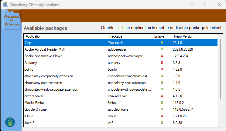

Posted: Mon Oct 16, 2023 4:05 pm
We released 3.6.0.4 this morning. We also updated the setup guide to now reflect the new Client Approved Apps list.
The global app list provides the base for all approved apps at the client level. In the Global Apps list you will want to add and enable any apps you want visible at the client level.
At the client level you will see a globally approved list of apps that are disabled for the client. Double clicking any app in list will enable/ disable app for client.
Screenshot 2023-10-16 120644.png (34.95 KiB) Viewed 55474 times
@PL-MSTech
I have reviewed the main App table and it is set to have the Primary Key be the reponame (package name) of Application, This should prevent you from getting duplicates as your seeing. Your table may have not dropped as it should and is of the old 3.5 version.
I would execute this SQL and then restart the DBagent, allow a few seconds afterwards for DB agent to recreate table.
DROP TABLE If Exists plugin_p4a_chocolatey_applications;
I also now with the addition of a client apps list, enabled more of the global apps that default in the global list so they are seen available at the client level. (Just a FYI, know if app is missing from client list it must of been disabled globally already.)
Posted: Mon Oct 16, 2023 4:11 pm
@PL-MSTech
Yeap, and if I would of looked a bit closer to your image provided I would of seen the (%) signs beside each of the app names. This is classic 3.5 table data so you need to refresh that table and get updated table structure.
I can see this causing you issues all over the place if Applications table is not accurately configured.
