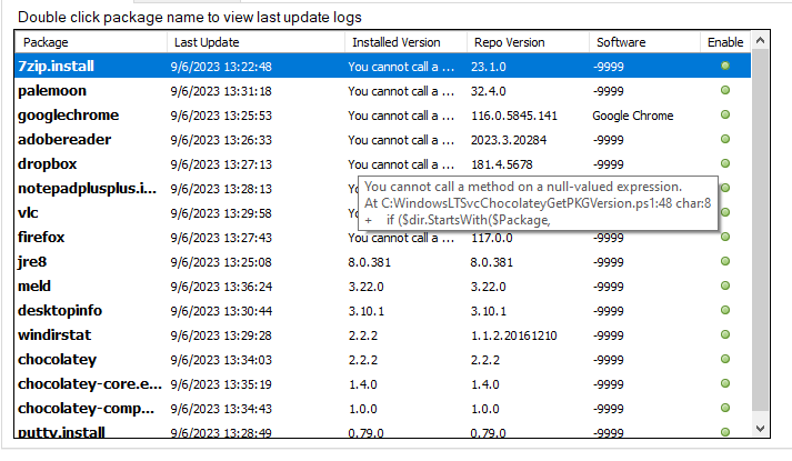

We are making progress, but many of the applications still have this error in commands from the script:
You cannot call a method on a null-valued expression.
At C:\Windows\LTSvc\Chocolatey\GetPKGVersion.ps1:48 char:8
+ if ($dir.StartsWith($Package,"CurrentCultureIgnoreCase")) {
+ CategoryInfo : InvalidOperation: (:) [], RuntimeException
+ FullyQualifiedErrorId : InvokeMethodOnNull

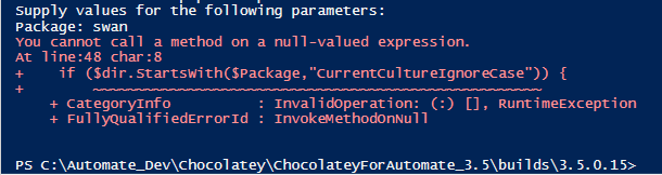

From your image it looks like some of the versioning is now updating where others remain with the error you are reporting.
The error is the POSH script failing and returning the error instead of a version value. The error being reported is that "$Package" is null so trying to run a method "StartsWith" fails when compared to NULL.
I believe that a previous issue caused apps to be reported as installed but not so your seeing these packages now fail version tests.
Here I run the same POSH script with a bogus package name, one I know is not installed (swan).

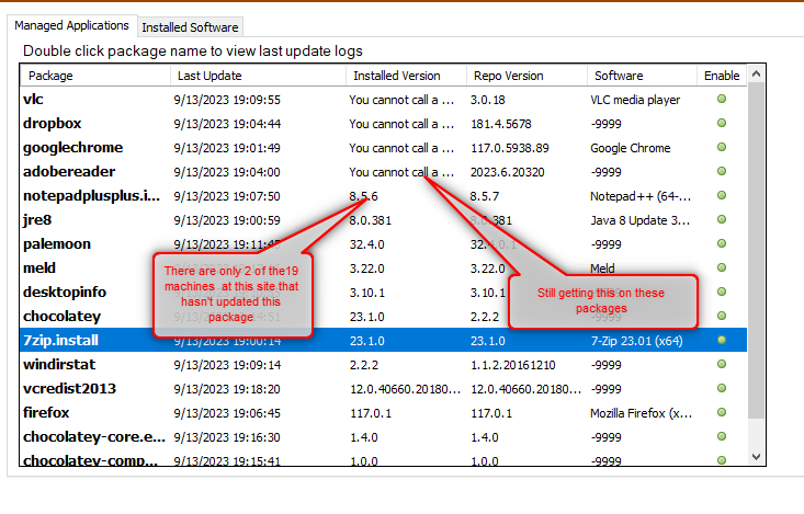

Posted: Mon Sep 18, 2023 10:53 pm
by PL-MSTech
Ok... looks like (at this initial test site anyway), the managed apps are showing up.
But it doesn't look like the "you cannot call a method" has cleared up.
Also, some script results return a statement like this:
Command returned [firefox] current version is [ 117.0.1 ]
And some return an 'OK' like this:
Command returned [dropbox] current version is [ OK ]
If it returns the 'OK' does that mean no update is needed, and if it returns the version, then it is going to update?
Because for notepad++, the result was: Command returned [notepadplusplus.install] current version is [ 8.5.6 ], even though the repo cache (and all other machines) was at 8.5.7... and it still didn't update.
The script has been running each day on those 2 machinnes shown in the image, and the repo cache version has been at 8.5.7 for a long time, but that result (current version is 8.5.6) still shows up every day... so why are the scripts on those machines not noticing that they need an update?
