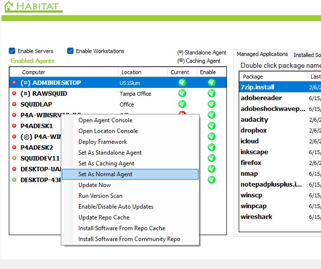

Posted: Tue Jun 28, 2022 1:53 pm
If you are on version 1.0.1.26 then you should have a "Set to Normal" menu item available to you on the agent menus. This will remove the caching agent duties from an agent. You can also select a different agent at same location and it will take over and auto remove the original agent from this duty.
So 2 ways to change or remove caching agent.

Posted: Tue Jun 28, 2022 2:29 pm
by eurgello
Thanks. We are still on version 24. I've enabled the servers and have made the server with the cache folder as the caching agent but the other is still showing as a caching agent even though they are on the same location?
As I don't think the non-domain WS is able to access it. I just ran the commands you provided and there wasn't a response. Tried to remotely access the shared folder through there but still failed.
I will update again once I confirm if still getting an issue with the caching agent that is the server.
