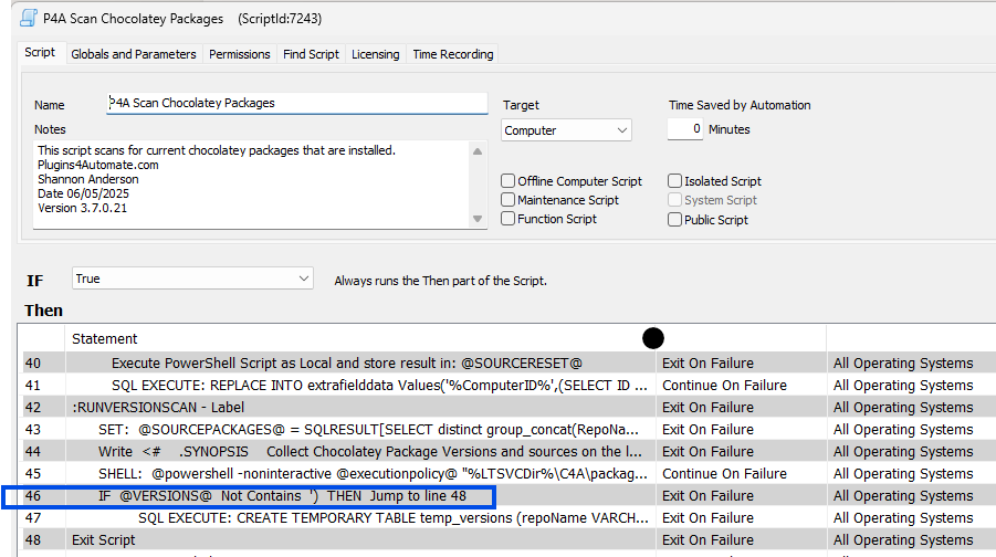

Then something above the SQL call has failed.
The SQL Code uses a LTScript Variable called "@VERSIONS@" to complete the SQL query.
CREATE TEMPORARY TABLE temp_versions (repoName VARCHAR(255), Version VARCHAR(255));
INSERT INTO temp_versions (repoName, Version) VALUES @VERSIONS@;
UPDATE plugin_p4a_chocolatey_applications AS main JOIN temp_versions AS temp ON main.repoName = temp.repoName SET main.Version = temp.Version;
DROP TEMPORARY TABLE temp_versions;
@VERSIONS@ should equal something like the following -> ('packageName1','1.2.3'),('packageName2','2.3.4')
There is a test at line 46 that should cause script to exit without executing SQL if the ending " ')" is missing from @VERSIONS@ so if @VERSIONS@ does not exist this will catch that.
Screenshot 2025-06-26 102520.png (53.02 KiB) Viewed 87464 times
If it continues, add a scriptlog line under line 46 but before SQL line 47 to print out @VERSIONS@ to script log. Lets see what that data looks like.
