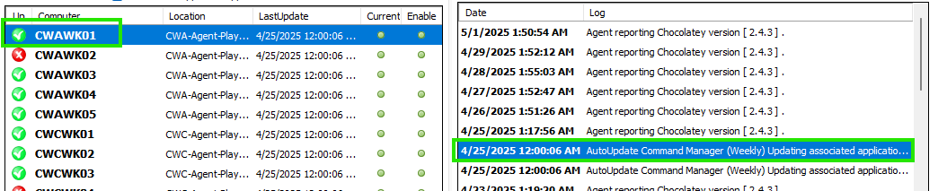

I have a weekly scheduled update set for these agents
Screenshot 2025-05-01 095736.png (45.94 KiB) Viewed 11875 times
How updates work.
  1. You set a schedule or by default enabled agents update daily
  • Based on schedule the Automate backend will send a command to online and enabled agents to "choco update all"
  • Agent log is updated that updates were sent to agent as a command.
At one point, we were updating packages individually, but we found that this led to a higher failure rate due to package dependencies, script schedules being affected or delayed by local agent time, and a few other Automate annoyances.
So to lower the load on the Automate Host and to speed up the process of updates we now send the agents a direct command to update verses scheduling a script, executing a script, processing each script function and logging the results.
We also improve the command process by allowing the agent's command to be pushed down and released so that Automate does not have to monitor and track the commands progress and process any results. The command creates its own process on agent and releases Automate's command threads. This greatly speeds up the processing of updates across large MSPs (2000 agents+).
