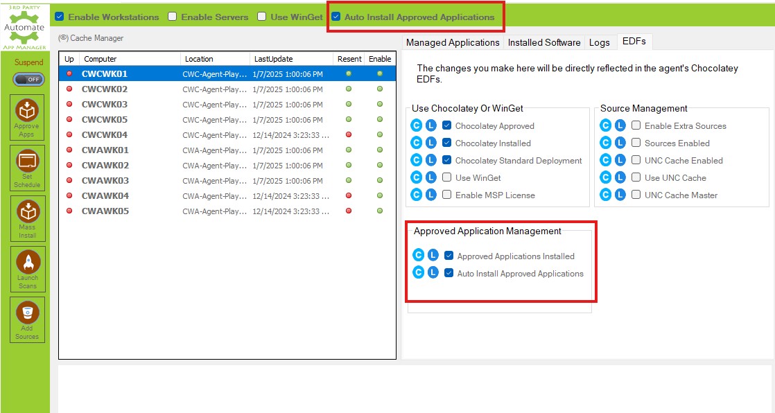

If you do not want to have applications auto install when not present on agent. Make sure that at the client level the Auto install box is uncheked. You can then verify any agent by looking at the edf's for Auto install and verify they are unchecked. If the state of unchecked is true then no packages will be pushed to agent. Enabled or not. Enabled at the client level will allow packages to be manually pushed via the plugin is no automation is selected.
Screenshot 2025-01-14 152424.jpg (136.31 KiB) Viewed 29727 times

They work together but only if the Auto Install Approved Applications is checked first. Then if the "Approved Applications Installed" is checked the system will believe the job was done and completed. No new action on this agent will take place until somthing in the environment changes. At which time the environment will uncheck "Approved Applications Installed" which if the agent has "Auto Install Approved Applications" checked, the system will force agent to retest all currently installed applications against the current Approved applications list. If there is an application missing on the agent, the agent will install the new application and after completion will recheck "Approved Applications Installed".
