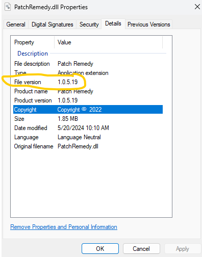

Test the plugin dll by right clicking it and selecting properties.
Is the file version showing 1.0.5 on the plugin you install to server? This image is for Patch Remedy but your FileHog DLL should show it's version here as well.
Screenshot 2024-05-22 142144.png (21.62 KiB) Viewed 148502 times

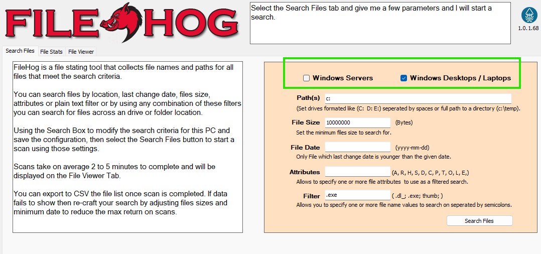

Client Tab
The Client Tab has changed to include a wider and easier to read layout.

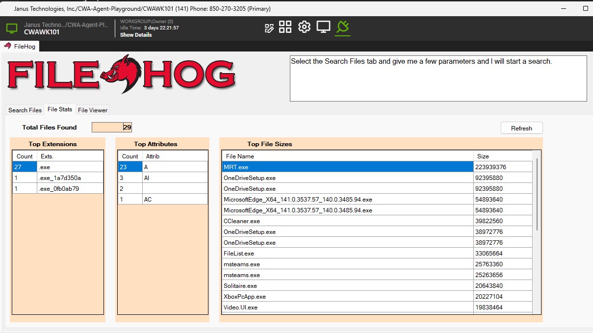

Agent Search View
Updated all views with fill columns and increased size.

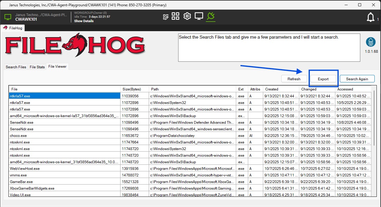

Agent File Viewer
The big change here is how the export happens and where file is saved. After export it will ask if you want to open the file making a confirmation of data quick and easy.
