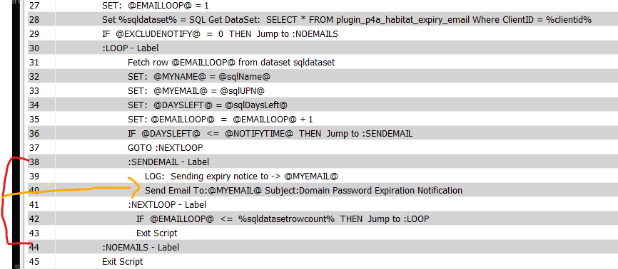

The password Expired emails are sent using a LTscript. This script checks for and loops through all the emails from client data and sends a email using the scripted email command in LT scripts.
Screenshot 2024-03-04 085813.png (37.69 KiB) Viewed 216017 times
This script typically runs on the DC for that client or location. Check the script logs from the DC agent to see if during the 12 Am or 1 pm hour Expiry script runs on DC and spits out log.
Keep in mind Expiry sends 1 email only. It does not repeated flood users with emails. It may end up in users spam.
Each email sent will have a corresponding email log entry as seen in script.

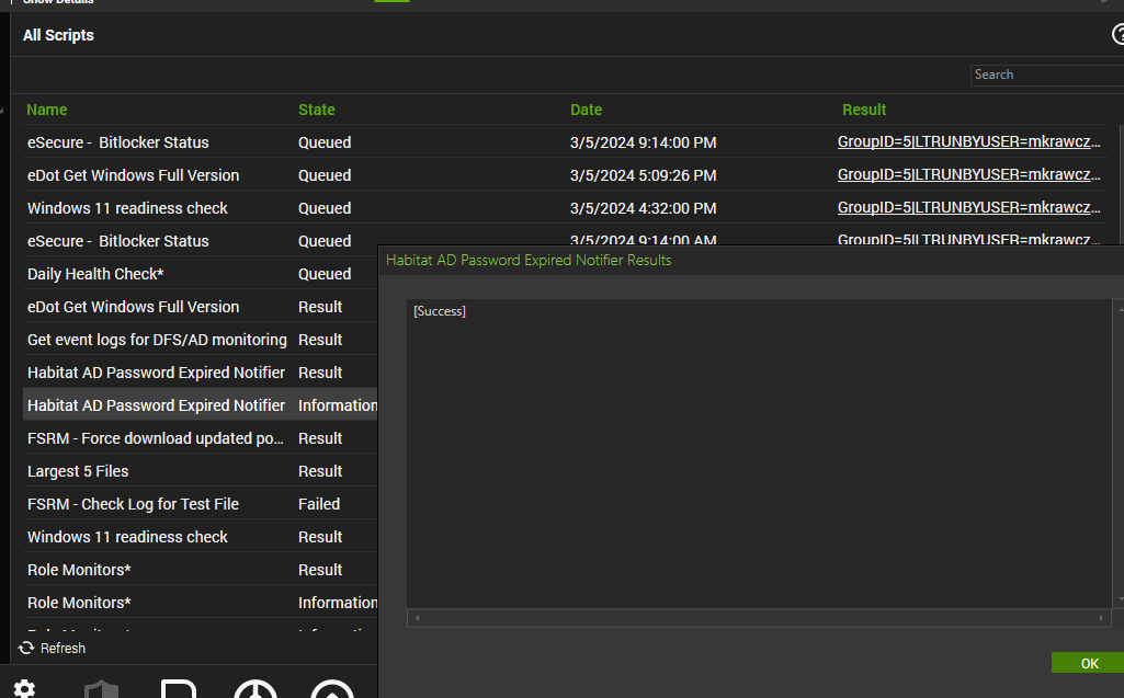

Unless there is a separate place, the script log when it runs just shows "success" from this AM.
pmg ss.png (84.59 KiB) Viewed 215995 times
Re: emails not being sent from AD notifier
Posted: Wed Mar 06, 2024 6:06 pm
Ok so you are using Habitats AD notifier and not the standalone version... Just so I know where to go look for issues.
Success is given on line 13 after the main read and save of data. next we execute a Powershell script to see if we are between time frame 8am and 3 pm, if so script echos "sendmail" to which we drop into loop to send any email needed.
It looks like your script is not running at 1pm as it should, which would put it between 8am and 3pm which would past test.
$min = Get-Date '8:00'
$max = Get-Date '16:00'
$now = Get-Date
if ($min.TimeOfDay -le $now.TimeOfDay -and $max.TimeOfDay -ge $now.TimeOfDay) {
  # send mail
   write-output "sendmail"
Script should run twice a day, 12 am ish, and 1pm ish. The test prevents 2 emails from being sent in same day forcing it to skip the first run of script and only send email on second run of script.
What time did script run?

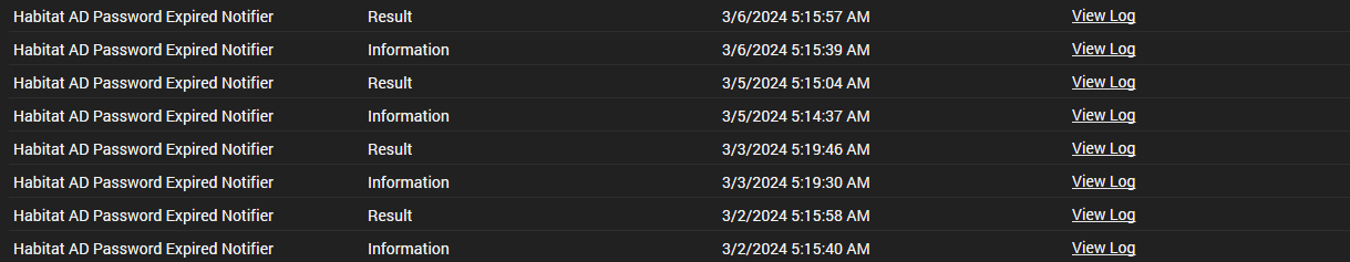

The script only seems to be running around 5 am. I'll try editing those script lines out.
Posted: Thu Mar 07, 2024 7:56 pm
That is odd... should be on ISync timing in Automate which is 12 am and 1PM (twice a day).
I'll go look and see if I may have adjusted something to cause it to change.
Otherwise the edits will fix you up.

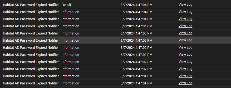

Update. The script just ran on the client except this time. I see all the script log entries for who it sent out which I confirmed shows up in the clients email logs.
So seems like something is throwing off the script timing by 5 hours?
