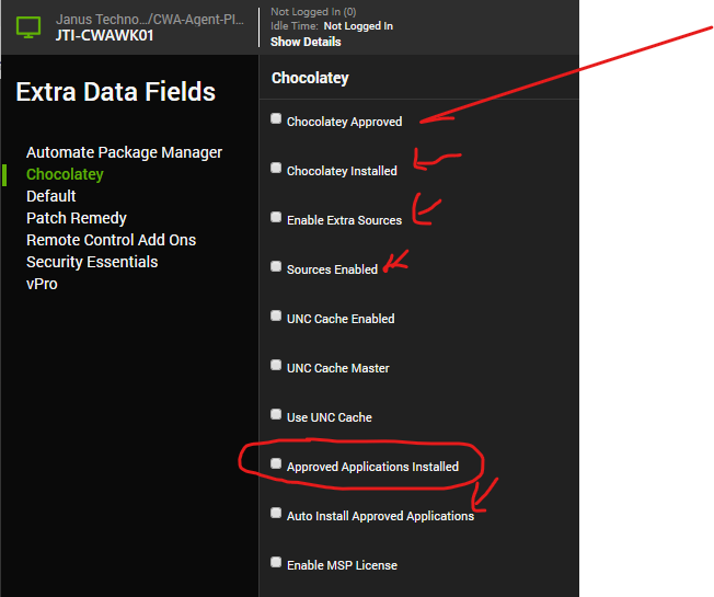

Source will not be reflexed in the command sent to agent. Agent should already have sources defined and pushed down to them. Here is how to define agent status quickly.
Getting Agents Status
Screenshot 2024-01-29 095724.png (54.69 KiB) Viewed 4236 times
You can view the EDFs under Chocolatey to see the current status of agent. If you need to correct a fault in an agent like for example, Sources was set (Enable Extra Sources checkbox checked) and sources show in EDFs they were pushed out (Sources Enabled checkbox checked). If you tested sources and found that there were some error in the sources or that the sources failed to update Chocolatey then unchecking the (Sources enabled checkbox) would force agent to re apply current sources.
The EDFs are broken up in to two checkboxes per task. A checkbox to tell automation to do something and a second checkbox that automate will set when task was completed.
  • Chocolatey Approved and Chocolatey Installed
  • Enable Extra Sources and Sources Enabled
  • Use UNC Cache and UNC Cache Enabled
  • Auto Install Approved Applications and Approved Applications installed
Unchecking the later checkbox for any of these settings will force agent to reapply setting in automation. Unchecking the first checkbox will disable that automated service.
