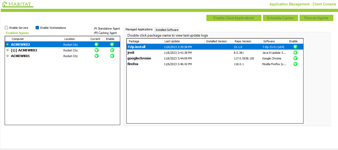

After 24 hours your new client should look somewhat like this,
Screenshot 2023-11-07 111536.png (43.21 KiB) Viewed 32664 times
