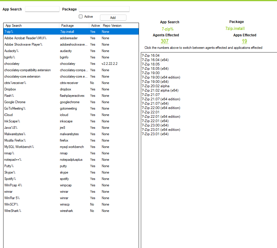

Also we're onto day 3 of having app manager enabled for all of our clients. However when looking at the plugin, all the repo versions are still none. Have we missed a step? We've read the documentation a few times now and can't see anything obvious we've missed.

Posted: Fri Aug 25, 2023 3:37 pm
Have you setup any caches yet? You need a cache setup and a caching manager running. We will start capturing master versions once an available agent is present.

Looks like we have identified an issue with Chocolatey versions causing some odd behavior. I will have an update out today.
