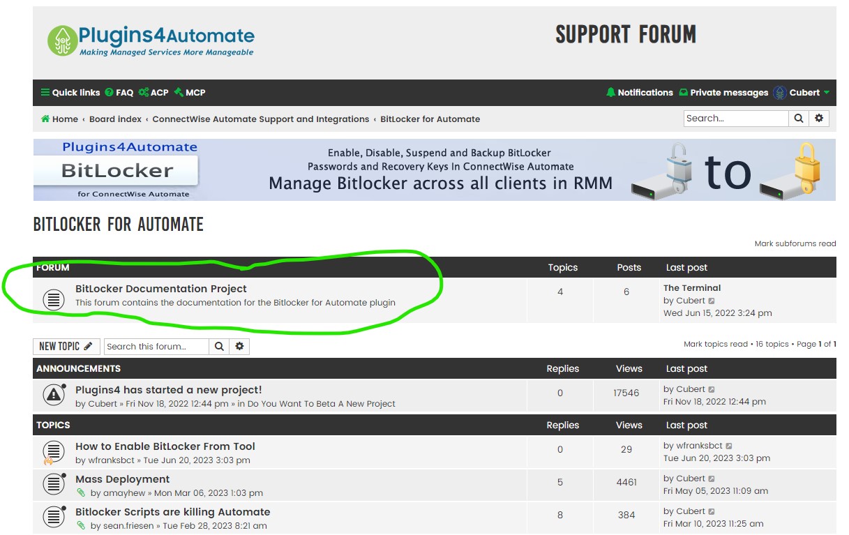

You were pretty close, just needed to look up from main bitlocker forum view. Here is the basic documentation for the plugin after it is successfully installed.
viewforum.php?f=70

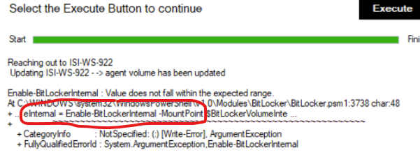

If you add a key, We will enable encryption, you can see it in the error you provided.
Screenshot 2024-05-13 132137.png (94.98 KiB) Viewed 46596 times

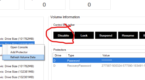

outside of adding a protector, Disable/enable button should send a request to bitlocker to enable or disable.
Screenshot 2024-05-13 132451.png (37.15 KiB) Viewed 46596 times

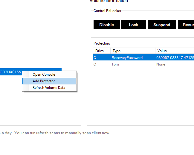

Which protector are you attempting to apply?
From your image, It appears to already have 2 protectors applied, a TPM and a recovery password.
Can you post the response from the protector your adding in the console window provided when the process is sent to agent?
