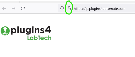

Posted: Mon Apr 24, 2023 2:07 pm
I suspect you may have a different problem.
Here is the URL in question: (safe)
Screenshot 2023-04-24 095532.png (14.84 KiB) Viewed 28389 times
and here is the code in the plugin:
Screenshot 2023-04-24 095903.png (15.09 KiB) Viewed 28389 times
Both are the same address so if plugin is trying to call https://lp.plugins4labtech.com then it is not he DLL for version 2.0.1.105.
This is actually not uncommon with Automate as it sometimes fails to pass down the DLL to the client control center. It shows the correct version on the Automate server and in the control center plugin manager but the local console is not getting the DLL updated.
We have this issue documented here.
viewtopic.php?t=5523
In the case of the article above it's not a license issue they see but a version issue inside the plugin. In your case the plugin changes the target of the license service so you would see it still attempting to contact old URL. This is what we are suspecting is happening.
So follow the articles instructions to delete your plugins folder and relaunch the control center. Then retry the plugin and see if you are still getting SSL errors.
Re: plugin crashes with ssl error
Posted: Fri May 05, 2023 6:00 pm
by cbacon
Yes that fixed it. Thxs
