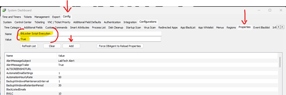

Sorry for the long response, I took a look at the plugin and added in a new feature to set scans at once a day for you from the default 4 times a day.
Here is the new plugin download, You will need to update current plugin and restart DBagent to take effect.
https://delivery.shopifyapps.com/-/e82c ... 513eaaf0db
Add property BitLocker Script Execution with value of True to set to once per day.

Sorry it took so long, had to get back into code to insert your request.
So yes, in build 1.0.0.16 you can set a property value that will stop the automated service.
Here is the DL link https://delivery.shopifyapps.com/-/dac5 ... 398b66bdee
Add to your properties config in Automate dashboard this new property
BitLocker NoScan and give it a value of 1.
This will stop the automation.
I would also restart the DBagent afterwards just to make sure that automate starts up seeing itself disabled.
