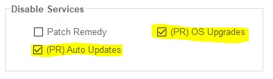

Cubert,

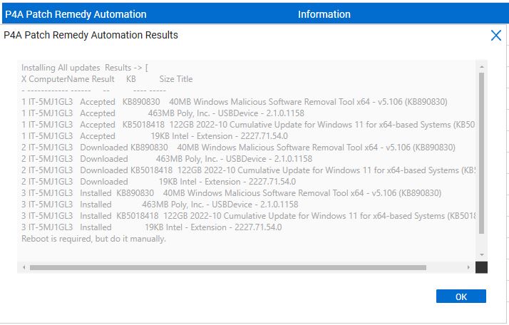

I did not set a schedule in Patch Remedy because we are using CWA patching but left the Patch Remedy check box enabled. My thought behind this was that Patch Remedy might still attempt to fix failed machines. Is this correct or does it not do that anymore? Having some users not getting the traditional reboot message we usually send and this is what I see in the logging:
It appears as though when they released the approvals Patch Remedy took control and did the patching but then didn't run the traditional message. Is that the way it's supposed to be?

If a checkbox is empty for (PR)Auto Updates then the client or agent is set to run updates as needed. Make sure that you check to disable service. The Patch Remedy checkbox is safe to leave unchecked and no updates should happen as a result of Patch Remedy. That checkbox turns off and on patch remedy data collectors.
Can you send me a screen shot of the PR5 client view and the agent view where checkboxes are displayed. Just snap a image and post it here so I can see how your configured.

It was configured with Patch Remedy unchecked, PR OS upgrades checked, and PR Auto Updates checked. I had to disable the Patch Remedy, because our users expect to receive a reboot message after updates. This seemed like unexpected behavior but the auto check boxes are still there, maybe just not working to disable it? Does this program allow us to find and fix failed updating computers anymore? Seems like some of the old functionality and reporting that was in version 4 is missing entirely from this "new" one. Let me know, if it doesn't do that stuff anymore?
Re: Patch Remedy box enabled
Posted: Tue Nov 22, 2022 3:10 pm
That would be correct, is that the agent or client box?
Posted: Tue Nov 22, 2022 3:19 pm

We checked the disabled box for the client and it still performed patch actions against the client outside of the policies set. At this point I've disabled it, doesn't seem to be a good fit for us.

I've had the same issue for the past year or the check boxes not being honored.
When we have (PR) auto updates disabled at the customer level, and Patch Remedy box enabled and not checked also at the customer level, I still see Patch Remedy trying to install updates on agents within that customer.
If I disable Patch Remedy by selecting the box to disable it at the customer level, then I no longer have updates trying to install outside of our various Group Policy configured schedules.
However, I would like to keep Patch Remedy enabled so it can still do data collection.
The only way this seems possible is to reenable Patch Remedy at the customer level over particular weekends when we need to get reports for a particular customer.
I would prefer to leave Patch Remedy enabled all the time for the data collection and reports, and not use it to run updates except when it shows that a system is not receiving updates for whatever reason.
I know its designed to do that, but for whatever reason, the clients still try to do updates via Patch Remedy even when that function is disabled.
I'm trying out the "P4A Patch Remedy Automation" properties to see if that has any impact on the issue.

If you go into any customer, check all boxes in disable services view, uncheck them all then recheck the AutoUpdates and OS updates so these services are disabled. Does the client try updating and if so how long did it take and how many agents under client effected?
This will help us understand if its happening during scans only or is something re-enabling agents afterwards.
