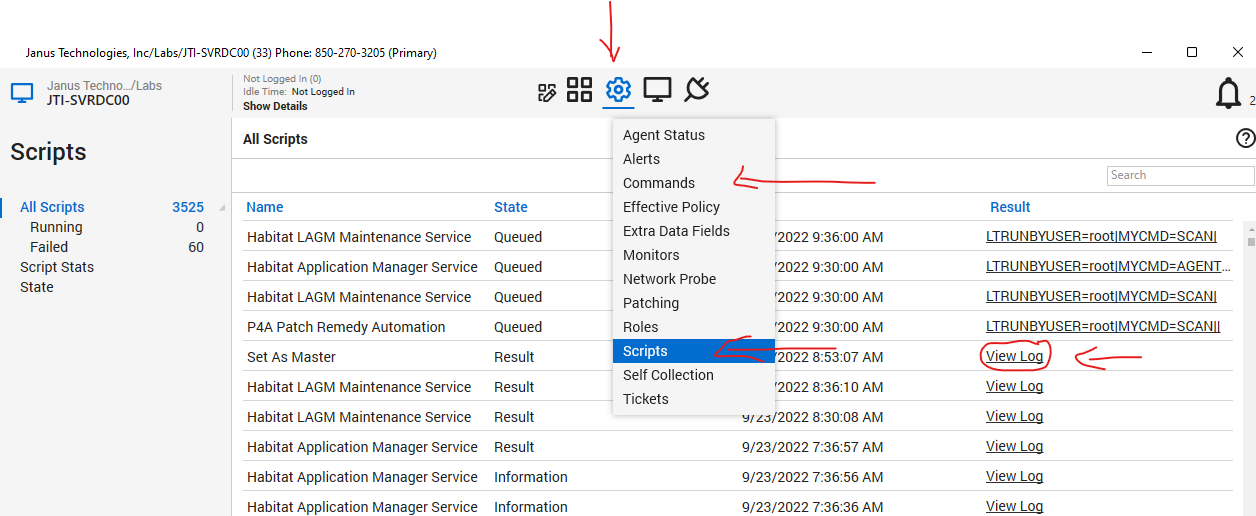

In the Control Center, Select the agent that is the Domain Controller for the client in question and open that agents console. Select the GEAR menu at top of console and select either scripts or commands. (I would start with scripts).
Automate scripts can call commands that will show up in the commands logs at the same time stamp as the script log entry happens. So if you read a script log that says error failed, then look for a command at the same time that also errored. The command log will show what the command returned including errors. The scrip logs are by script name, so you should see an ADUC script being scheduled and executed on the Domain Controller to capture Active Directory information and return it to Automate.
Screenshot 2022-09-23 085444.png (128.09 KiB) Viewed 236871 times

Thank you for clarifying this. I was physically looking for log files on machine :)
