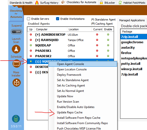

If you want to manually seed the cache folder to get it rolling and to verify that share permissions are working you can select a caching agent from list then select to update the cache from menu. This will assign a script to run on that agent immediately where you can then monitor the progress of that script and look for errors like failed to copy to share. This is the most common error we see and it tends to be permissions set on domain shares. Local NAS shares and workstation shares tend to have less permissions sets to overcome and are simpler to get setup.
Screenshot 2022-09-20 085744.png (60.44 KiB) Viewed 5880 times
