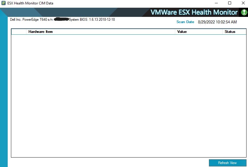

Running into an issue where we aren't able to view CIM data, but it seems like the data may be there, as we still get occasional alerts. Just makes it a bit harder to troubleshoot the issue.

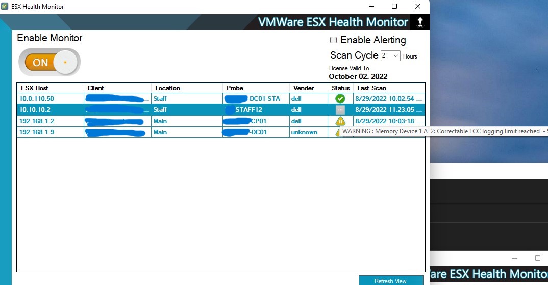

The main ESX health monitor displays status and last scan date. And if we hover over the statuses, we do see a truncated list of errors (if there are any). But when we right click > View CIM Data, the window is blank.
We're running hosted CWA v2022.8, plugin version 5.0.0.4. Any advice would be much appreciated! Thank you!!
EDIT: we have tried recreating all probes, disabling/re-enabling the plugin, and different CWA users. All yield the same blank CIM page.

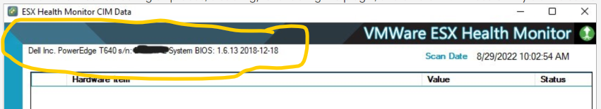

The fact that you have this in your CIM window says that we are speaking with the ESX host. Otherwise there would be no data here either.

If I query the database manually:
select * from plugin_p4l_vmware_healthmon_cimdata where ProbeID = 846
It also looks like all the CIM data is there. I did notice there were two "ESXHost" values for that one ProbeID - one for 10.10.10.2 (which we'd expect) and another from an old host. Out of pure reckless abandon, I deleted everything out of the _cimdata table where ProbeID=846. Rescanned, confirmed the _cimdata table was populated with new info... but the CIM window is still blank in the plugin :(
As a last-ditch effort, I ran our Control Center reset script, which basically deletes some registry values, as well as the "c:\programdata\Labtech Plugins" and "C:\ProgramData\Labtech Client\Cache" folder. But alas, still no data in the CIM menu.
Anything else I can try to help narrow down this issue?
thanks again Cubert!!

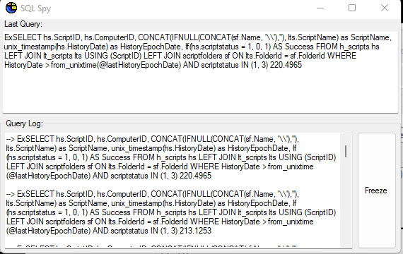

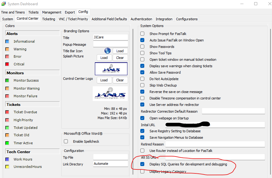

Also in your Control Center config you can set it to also launch a SQL-SPY windows that shows you all the sql queries that are taking place during the navigation on any tool or window in the control center.
You can monitor this window as you open the CIM windows to see the windows query the VMWare DB tables for the cim data.
SQLSpy will allow you to freeze the query log window so you can copy and paste the query that ran into a SQLYog window to test the return of the query.
This will help identify what was requested and what was returned to CIM window.
Turn it on in your Dashboard configs.
Screenshot 2022-09-07 085500.png (74.55 KiB) Viewed 23987 times
It auto launches when you open control center
Screenshot 2022-09-07 090023.png (31.48 KiB) Viewed 23986 times
