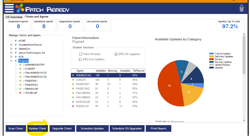

As for mass updates, We have a Client wide Update button that will cause Windows to reattempt and missing updates based on what's approved for Windows agent. This can be executed at will and will tell Windows to reprocess missing updates on all agents under client.
We do not have a Automate Wide update button current available but id that is something you might find useful we can look to add that into Patch Remedy. Keep in mind that this only works on "online agents" so if you have a client with alot of offline agents during the time you execute this, they will be skipped.
