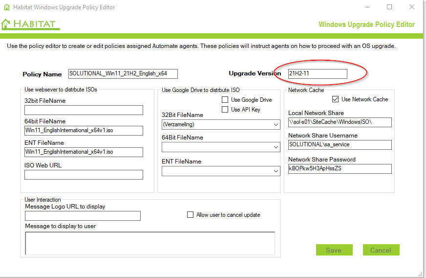

Sure,
Not sure what change overnight, but now a file is being downloaded that was there for a long time except it's the wrong one...
I've attached images of the location setup:
The Habitat - Upgrade assistent setup for the local image that has been placed in the SiteCache share.:
Script is downloading file 21H2_64.ISO from the SiteCache to c:\temp\21H2.ISO, however it should download file 'Win11_EnglishInternational_x64v1' I placed there to the C:\temp and use that instead.
Should I fill in one of the fields to set the filename to make sure the W11 iso is being downloaded?
Also, is there a way to hide the passwords that are being used? They might be in logfiles etc...
Hope to hear soon!

Actually from your setup shown I am surprised anything shows downloaded....
You say it should be downloading -> 'Win11_EnglishInternational_x64v1'
I don't see where did you tell it to do this? The areas where you tell the plugin the actual file names are blank. (see image)
Screenshot 2022-07-28 090700.png (36.02 KiB) Viewed 6818 times
The plugin knows what file to apply by combining the Local network Share and the (32bit,64bit,Ent) iso file names to complete the URI needed to acquire the file. With out the file names it can not complete the download and would exit script logging that files didn't exist in agent script logs.
Here is some support documentation about the upgrade services.
viewtopic.php?t=5657

Posted: Tue Aug 02, 2022 2:47 pm
by lblokland
Please see below, I have changed the settings but still the W10 image is applied....
Succesfully though, but the wrong image is downloaded.
In the script logs I can see the target image name in c:\temp (21H2.iso) but not the source that is being downloaded.
Any thoughts?
Thanks!
Leon

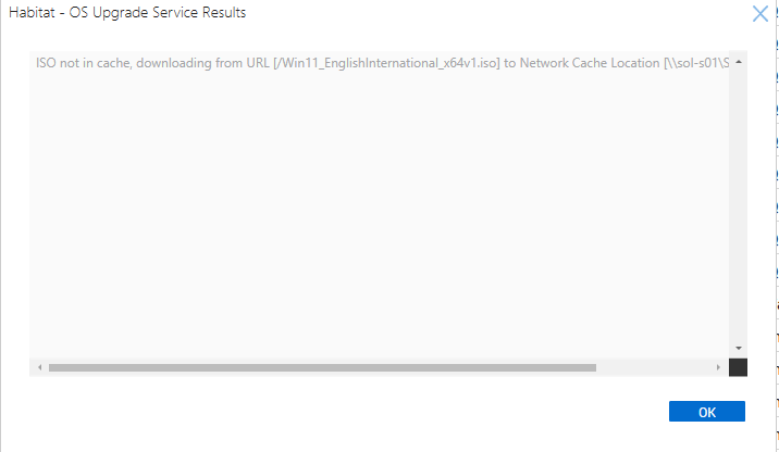

Re: OS Upgrade script - the network path was not found
Posted: Wed Aug 03, 2022 1:20 pm
You should monitor the script logs to see what's going on and when. It should alert you to issues.
Screenshot 2022-08-03 091028.png (33.15 KiB) Viewed 6733 times
Send me these logs that you get here.
Posted: Wed Aug 03, 2022 2:05 pm
by lblokland
Not sure if this helps:
The Script(5906) failed in the Then section at step 321. The reason:

I also found that after changing settings it looks like the script is trying to download from an URL to the network cache, but it is in the network cache...
I don't understand the setting...I have specified the SiteCache settings, and the filenames under the URL part of the screen.
Looks like the script is thinking it now needs to download those files instead of looking it up in the SiteCache.
I did also change the version, as it is windows 11 I want to upgrade to. But that version number exists in 11 and 10...
I think I'm still missing something big, I might just not think 'habitat style'

I have to say that was harder than it had to be! I spent a little while defining how the script was getting that value. The original logic in automate code was a bit jumpy.
So I decided to fix it all!
We made this whole thing so much easier in the new Patch Remedy 5 so I decided to upgrade the Habitat OS upgrade service to the current PR5 standard. Below is the product of these changes.
So a new DLL is now available. Upgrade Habitat to 1.0.1.28 to get the new version of tool.
https://delivery.shopifyapps.com/-/ac4f ... b9b0ca9cc6
Here is the skinny:
Policies are out, you will not need to create different policies to define what ISO you want to use. We will assume that the latest feature upgrade is the intent and as such we do not need any file information from you to do that. We also simplified the user interaction.
If a user is logged into console desktop the script will prompt user to allow upgrade in the background to continue. If use allows then the upgrade continues else logs user canceled upgrade. If user is not logged in it will continue as directed.
In PR5 we moved the mass of the coding to a PowerShell script and out of the Automate scripting engine. So the new Habitat - OS Upgrade Service script is now just a few lines of automate code. This allows us to determine what is needed by OS prior to upgrade then allows us to use the Windows Upgrade Assistant to carry out the actual task. This is much cleaner and the added bonus is you do not need to supply files or locations.
The service is controlled by the automation management service so turns on and off by service setting.
Scheduled upgrades will have the script scheduled on all the selected agent the day of the schedule for the time set by schedule. This is done to prevent DBagent restarts and other DB tasks that might wipe a script schedule from dropping a schedule set farther in advance.
If you schedule script for same day but later in time, the script will be scheduled when you save schedule for the time set by schedule.
The "Update Now" menu item will run the scripts now on all selected agents.
Enjoy!!
