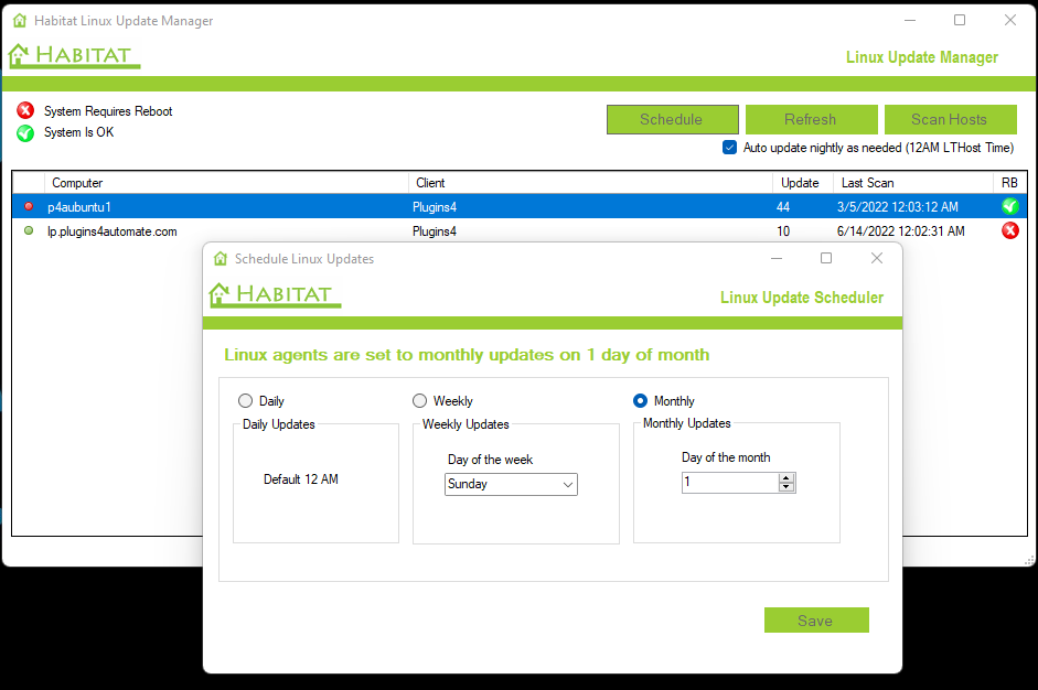

We just released Habitat 1.0.1.26 which adds the new Linux Update Scheduler function to the global tool. Not to bad, request for feature under 20 days...
Habitat should auto update over the next 24 hours or you can manually update using link below.
https://delivery.shopifyapps.com/-/c76b ... c061cc8371
Here is what it looks like..
