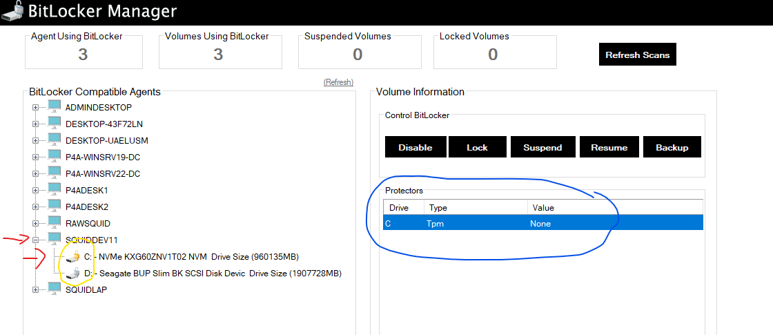

The image below shows that if you select an agent it will expand and should show you gold or silver drives. Gold drives are secured (encrypted). To the right if you select the encrypted drive it will display the key protectors it sees on agent. If it is using TPM only then there is no key as the key is the hardware setup and not a physical number.

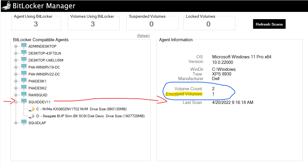

Also if you only select the agent and do not select a drive it should report on how many drives are encrypted on agent.

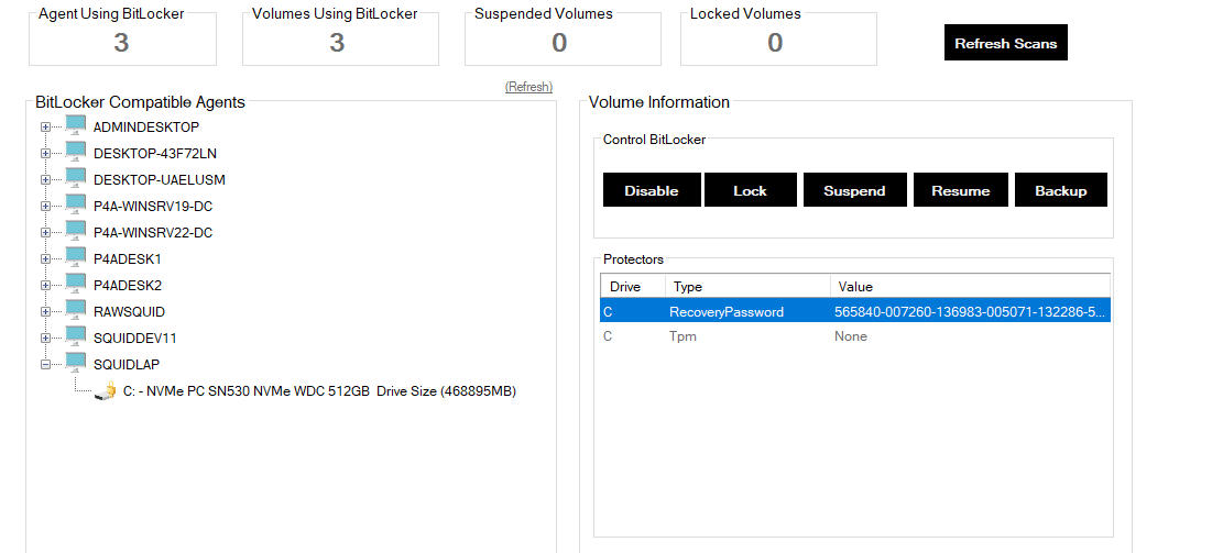

You can TPM or TPM with code or both. If a probe of a encrypted agent has a key for an key protector then our plugin should pick it up and display it. See image below.
